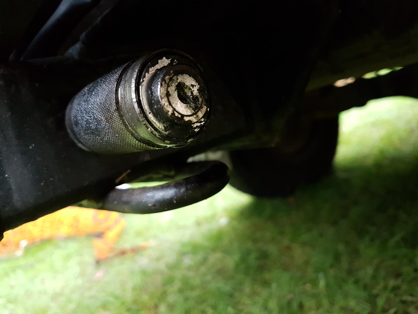

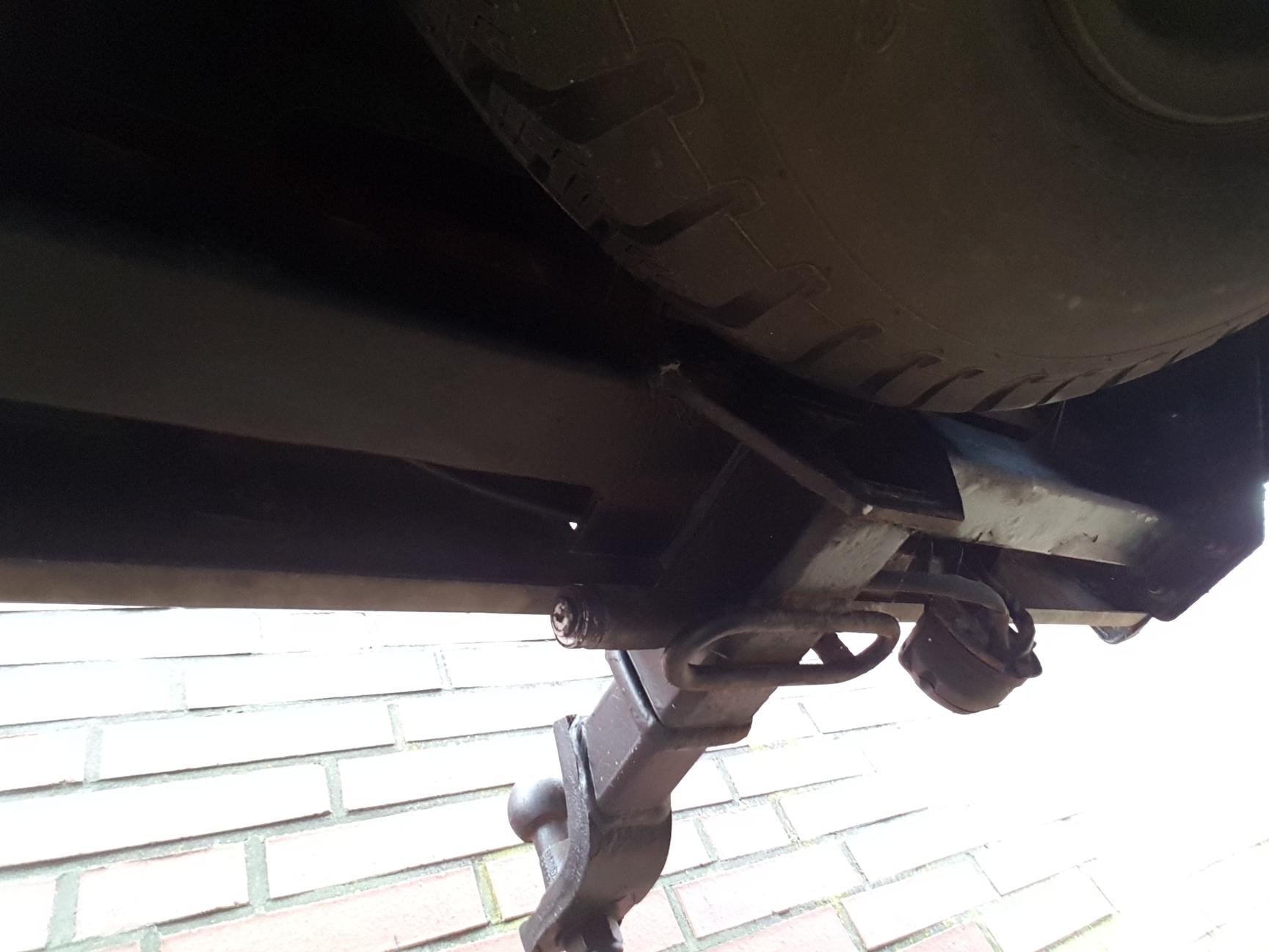

Here we go, the previous owner of my 4Runner applied some sort of wax as antirust tratment in the frame. Some of that wax's inside the tow ball mount lock, the key doesn't fit and I can't dismount that mount. It's some sort of sticky material. Do you kow a way to clean that stuff from the key hole?

Propane torch will get the wax out, but the lock might be frozen anyway. I've cut off several of those locking hitch pins over the years.
If the wax-oil is holding the lock tumblers, causing it to stick:
- spray the key entry hole with a good dose the Brake Klean...to flush clean
- I newer leave my 2" ball receiver mounted, all year long
- its inside my truck, until I need to tow...so I don't need a lockable hitch pin
If all else fails, cut locked pin off, with a thin angle grinder zip wheel.

It was a silly question maybe, but it's the first time I see a tow ball mount like that in here. We use something similar like this:
I'll try heat and Break Klean first.
If I can remove it I'll keep it inside the 4R.
Thank you for your advice.
