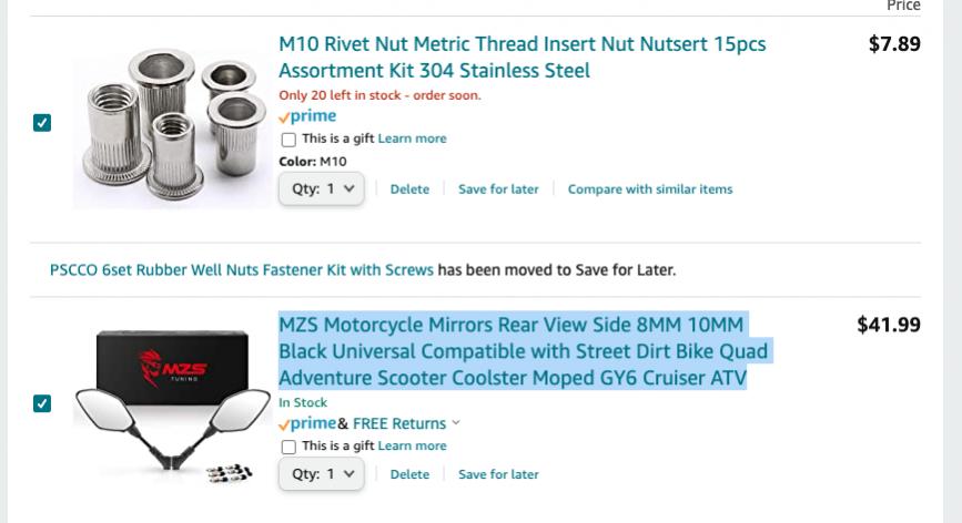

I searched the forum, and found a few threads on towing mirrors, and have decided to try my own solution.
Today I ordered these from Mr. Bezos.
My hope is to do the following:
1) drill a hole somewhere on or near the bottom outside corner of the existing mirrors.
2) Insert the rivet, nut.
3) Use the correct size screw to tighten down the rivet nut, thereby expanding the rivet, making it a permanent mount
4) Use a wrench to screw attach and adjust the convex mirrors that I purchased.
If all goes well, maybe I'll have some decent towing mirrors that I can quickly put on or take off with one wrench.
I'm probably going to put a backing plate on the inside of the plastic of my existing mirror, to reinforce and spread the load from the grommet.
I'll probably use a stainless steel fender washer. If I find a thin piece of some type of rubber, I might put that under the washer, to allow for some padding and to provide a little give and dampening effect to help make the mount more secure.
Lastly, If I seems a little weak, maybe I'd put some epoxy over the inside, or make a "cavasil" paste from epoxy and use it to reinforce the area.
Those are my plans. I'm not sure when i'll get to the project, but I'll post back on my results.
My hope is that by putting the nutwell on the bottom, it will be fairly innocuous when the mirror is removed, yet allow for a simple, secure and clean mounting when the mirror is installed.

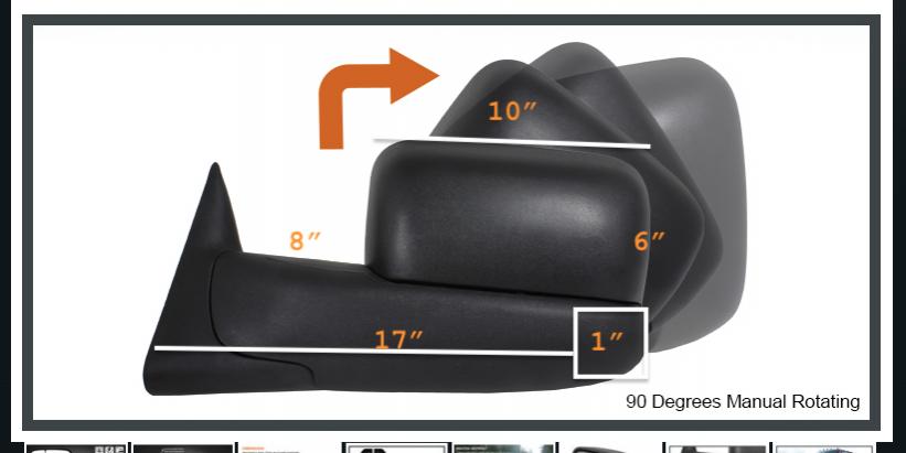

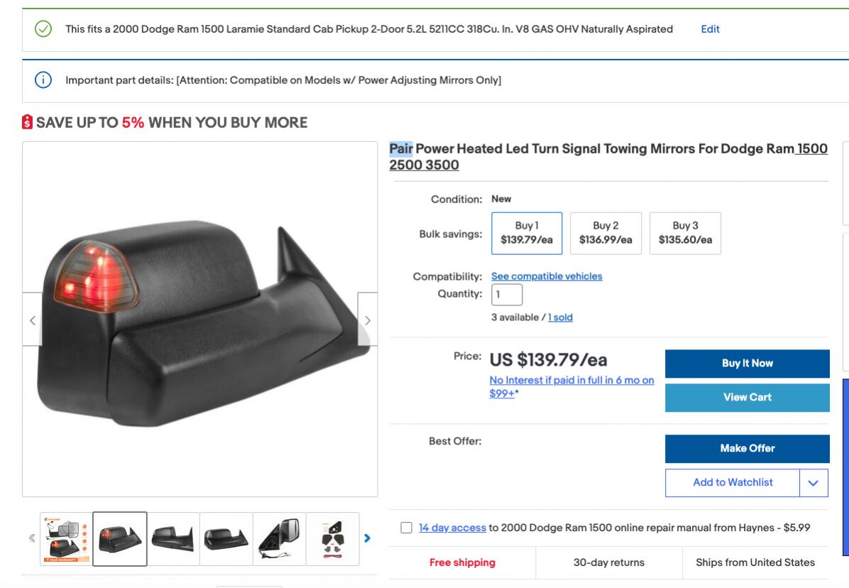

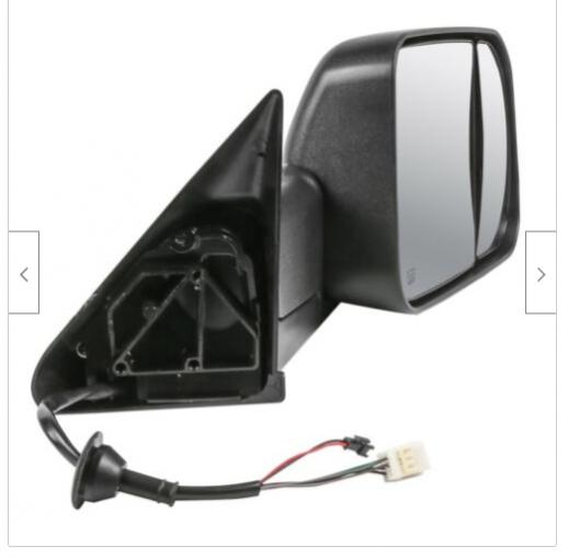

I've decided that I'm going to *try* some Dodge Ram mirrors.
He's the scoop... it looks there as some models that are 18" long in normal mode, and 24" in towing mode. That's shorter than some of the alternatives, so maybe they'll look OK.
The ones that I'm ordering are heated, electrically adjustable and have turn signal indicator in them.
Here's an image where I added the dimensions... it's the non-blinker version.
The other photos are of the blinker version I'm ordering.
So we'll see how this goes.

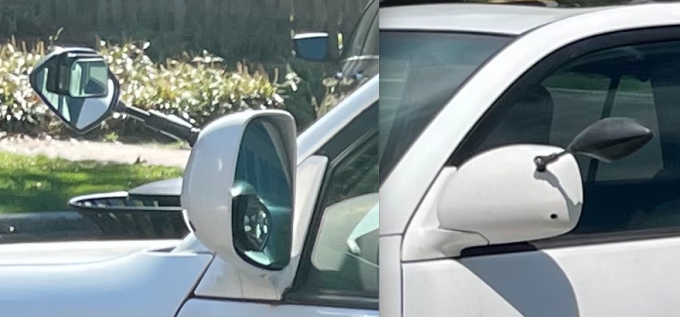

Here's an update... I went with the motorcycle mirrors.
I bought a rubber bushing at home depot. you put a bolt in the bushing and as you screw in the bolt, the bushing expands.
I drilled a hole on the outside of my mirror housing (being careful not to break the mirror's glass, and to choose a spot where I have clearance to adjust the mirror.
I then took apart the motorcycle mirror mounting hardware and it easily adapted to accept these bushings.
I'm mostly happy with the result. The mirrors usually need adjustment before I tow, but I don't mind the look, so I've left them on full time.
i manually fold the mirror in when parked on the street or going through a drive through.
If I did it again, I don't think I'd get convex mirrors. Flat ones would work better. But... the extension provided by these mirrors makes a night-and day difference, so overall I'm happy.
The small blind spot mirror on the extended mirror fell off (see photo showing it)... and I like the view better without it, so I left it off.
