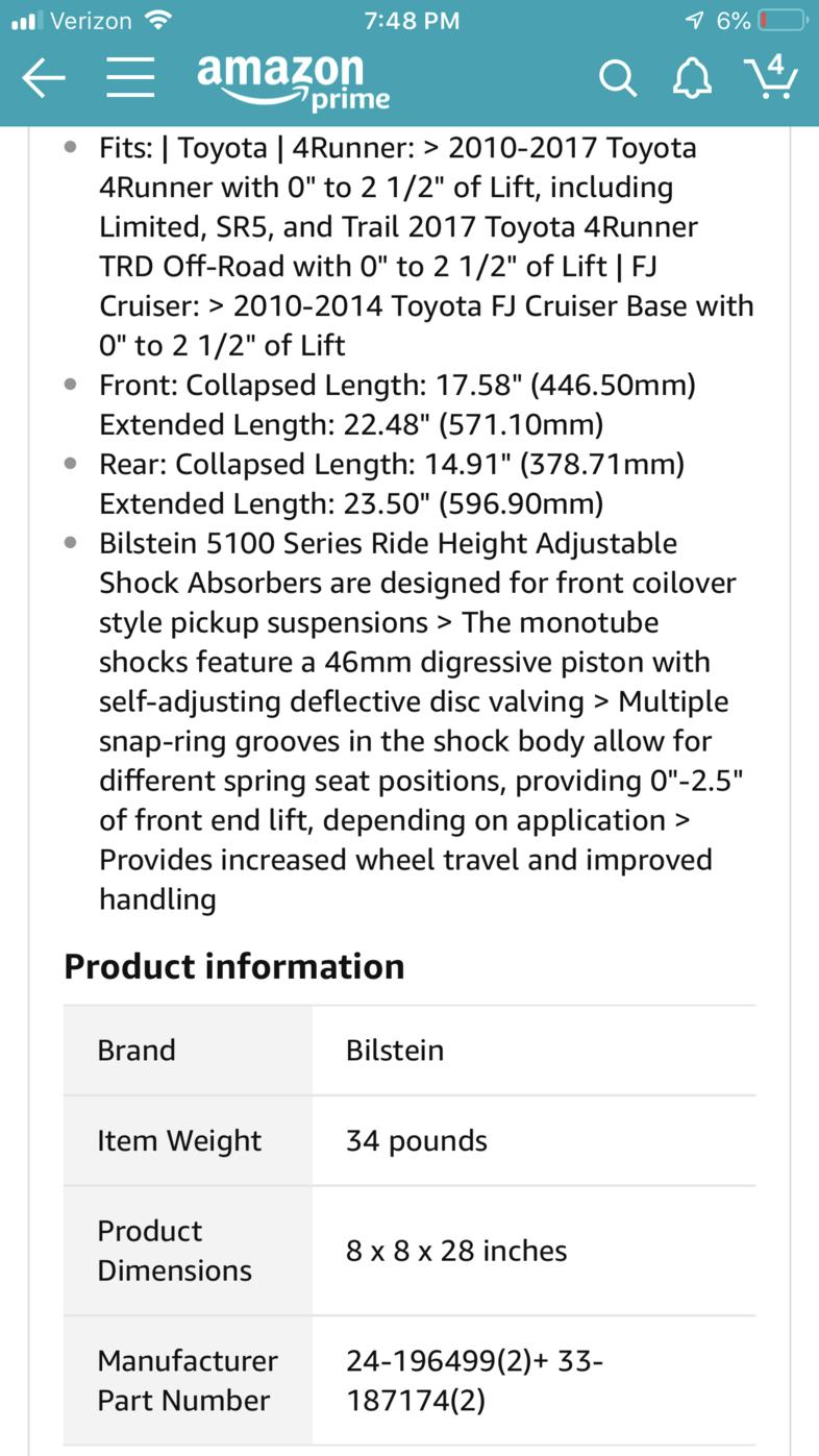

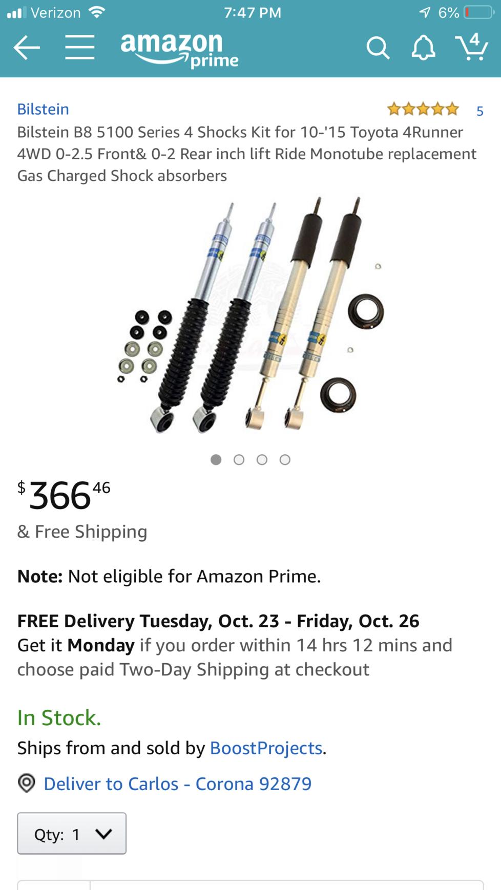

I just bought a 2018 SR5 4x4 and I want to do a modest suspension lift for extra clearance. I like the way the 4runner feels and handles so I’m not looking to do anything exreme with it. My family tent camps a lot but we’d like to get to some more remote camping locations and have a little fun exploring trails. We won’t be trying to do difficult rock crawling and this will also be a daily driver. I’ve read a lot of information on the forum and I think the Bilstein 5100 seems like a good place to start. I wanted to do a 3/2 lift but it seems like this one can only go up 2.75 in the front. So it won’t be exactly level but that’s pretty close. I will be getting bigger tires; either 275 or 285’s. I’m not sure that I want to trim any body moldings just yet. Anyone think this kit is a bad way to go? And would I need any other parts not included in this kit? I found this kit on amazon.

Unless that kit also comes with new springs for the rear, the rear will remain stock height. The more you deviate from stock suspension angles, the more you expedite wear. This is a decent kit. Add some springs from one of the various manufactures out there for the rear and you should be set. I'd stick with 2" lift in the front and 1-2" in the rear and stick with 275 tires if I was in your position with your goals.

Thanks Nate, I had read that the front worked with the existing springs so I assumed it was the same for the back. I’ll start looking into some spring options to go along with this. Once I get those springs I should have all the necessary parts needed right? I appreciate the help.

That kit will work with stock springs in the rear. You just won't get any lift in the rear if you don't change the springs. Should have everything else you need though.
I just installed those, and wanted the exact lift numbers you're after. I decided to add Dobinson's springs (302/325's), and I'm super happy with the results. After things settled, I got approx. 2.5" up front, and @2.0" in the rear. Install was easy. I went with the 302 spring for the lift up front, as opposed to using the spring perch on the shock, as I felt this was a better way to get the lift. You could just use your stock front springs, and use a higher setting on the shock body.

Thanks for that info olddude! Got any pictures? Would love to see how it sits. I think I’m going to use the stock spring in the front but I will certainly need to buy one for the back. I also decided on the tires. I’m going to get the Falken wildpeak AT3 in P275/70/17. I keep reading good things.
