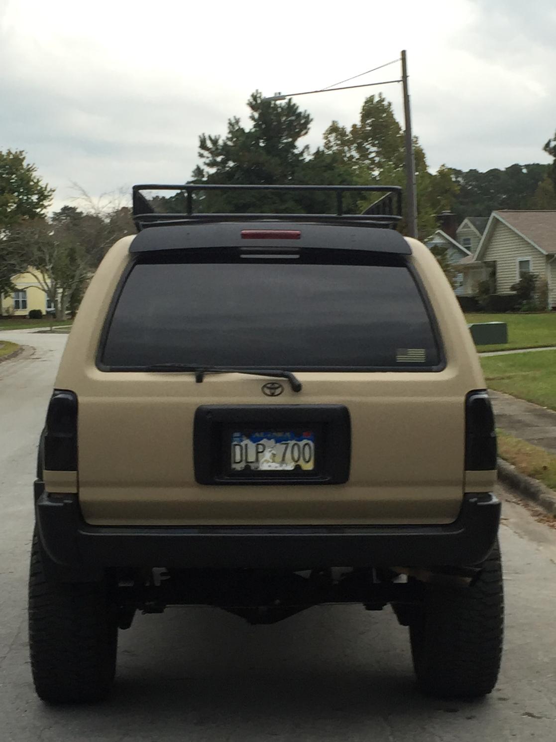

Dont knock the HF bender.
3/4" sch40 pipe, which equates to about 1" OD.
I like it! Are you going to cleanup/finish the welds and paint it next? Or are you going to put metal mesh on the bottom?
Looks good brother!! I was thinking about the hf bender but a concrete pylon was much more accessible to me.....and I only needed 2 bends.
Good job. I like a good bit of my HF tools and such, though don't ask them to perform everyday work, for they aren't built for such.
Beware, Gobi may come calling for patent infringement.
Thanks man.
Building it for a buddy of mine. In exchange he's making me Projectors. Whatever he wants to do next is on him. Still more work to do on it, but damn this rain.

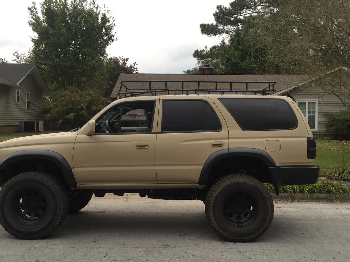

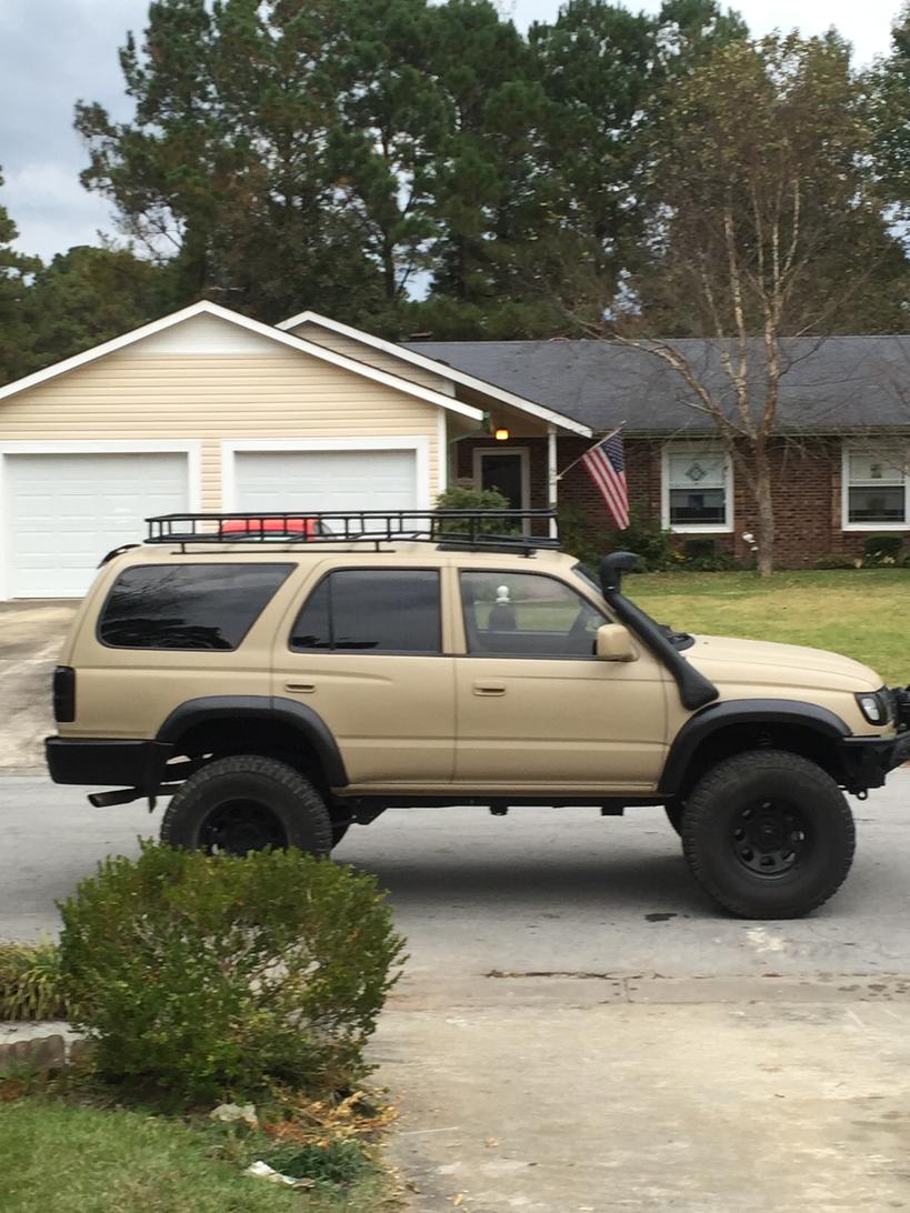

Doneski.
