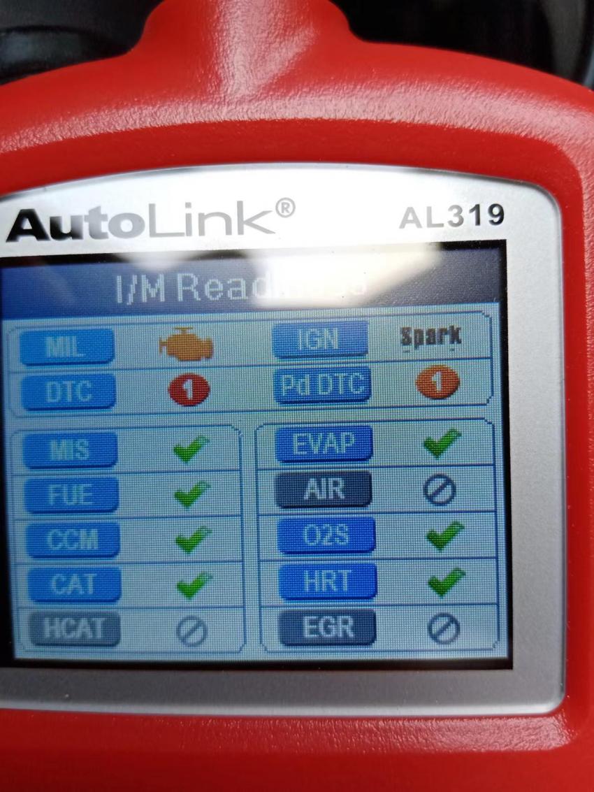

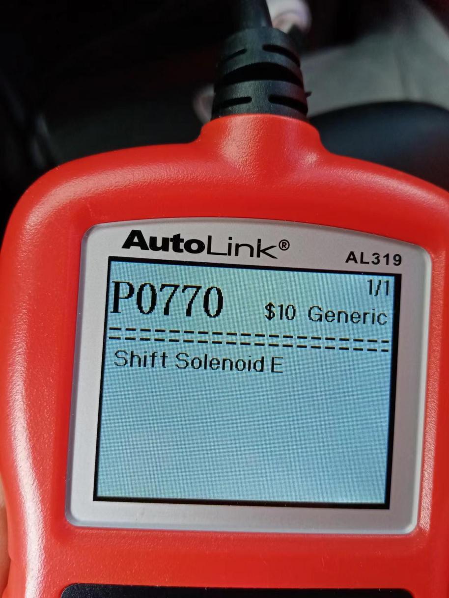

Sorry for the wait, everyone. I finally have the codes after someone let me borrow their code scanner or whatever its called. Please see the pictures attached here.
Other information is:
1. slipping
The truck's transmission is slipping and has a hard time going from 2nd to 3rd when it first starts up.
2. shaking, oil smell
The truck has started to shake a bit lately and seems to be emitting an oil smell ever since the Check Engine light came on.
3. clicking sound
There is an intermittent clicking sound coming from the engine area, it seems.
4. brakes are screeching a bit

Sorry if I came across snarky above, I just didn't want to see you get taken.
P0770 is the shift solenoid. I don't know much about how these transmissions work but it sounds like that is fixable, if that's the only problem.
The oil smell is more concerning. Ideally you could check the transmission temperature when running. The 99 outputs that from the computer but you'll need a Scangauge set up to read that, which sounds like isn't something you have easy access to.
I would suggest pulling up the trans dipstick and looking at the fluid colour. If it's brown and smells bad that isn't good.
