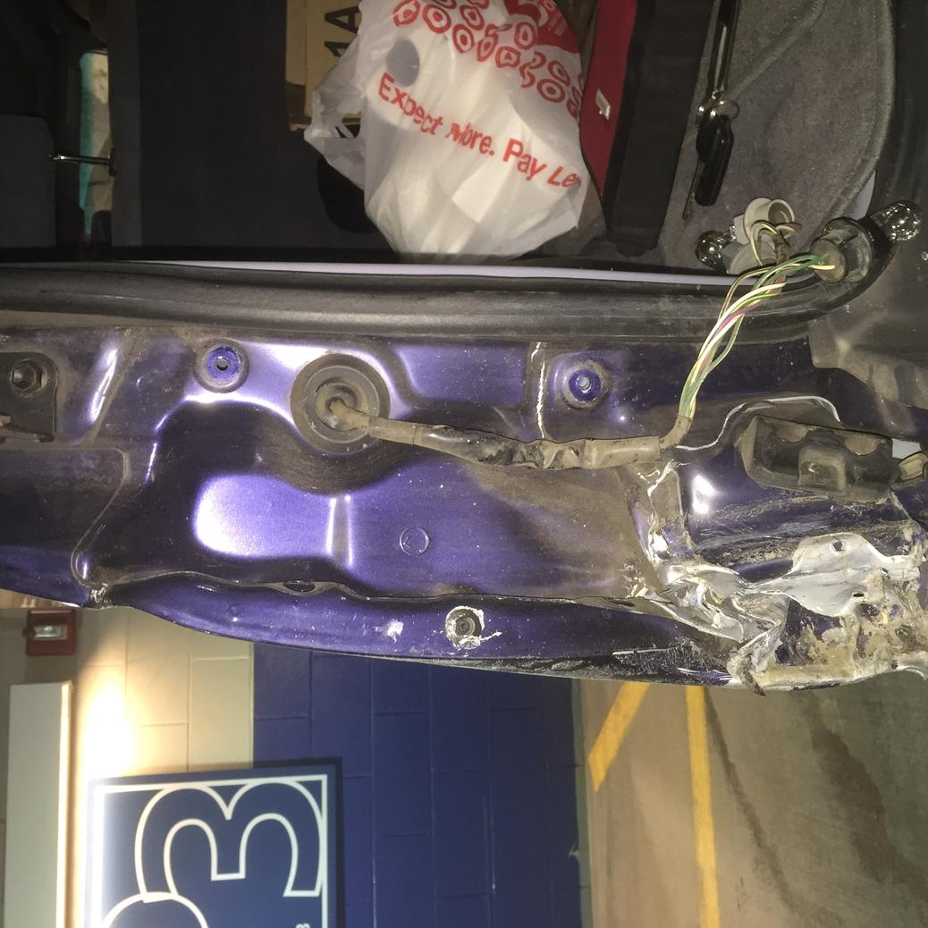

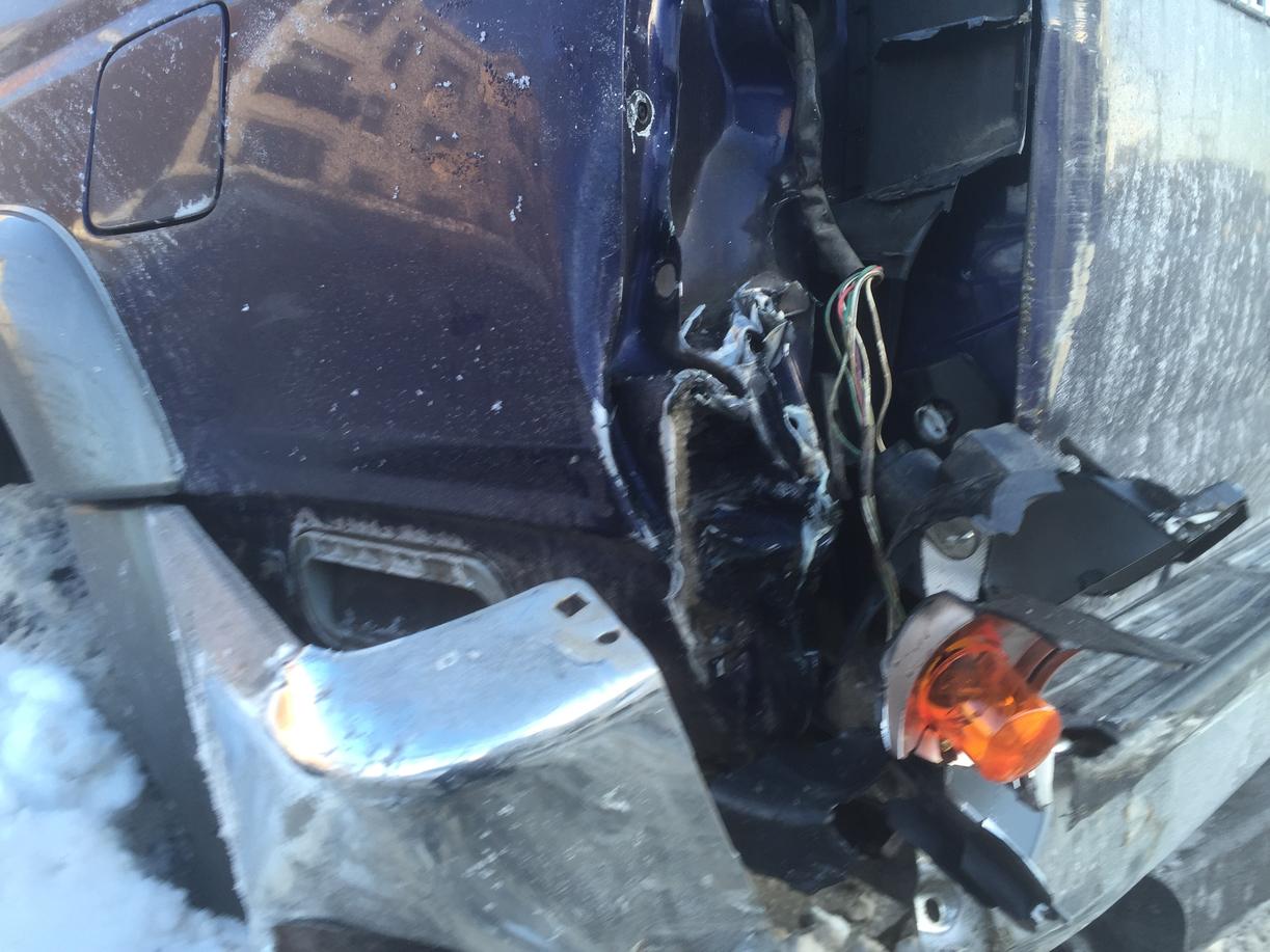

Boston bus hit my truck while parked one morning. Any ideas to fix?
2000 t4r sr5 with just over100k.
Maybe time for a new bumper but not sure how I can straighten the mangled corner.

Everything is fixable at a cost, in this case I think it would be a pretty simple fix for someone who knows how to do sheet metal work.

Fixable? Yes.
Labor Intensive? Yes
Labor Intensive = Expensive. I bet you don't see a quote below 2k.
Anyone think I can bang it out somehow from the inside?
NO!, don't make it worse for the guy who will fix it. Anything is fixable, this looks ugly but is actually very routine. I owned a body shop for 14 years, in the business over 30 and have seen worse get repaired without replacing the panel and not be butchered. There is always someone willing to do it for less, but are they qualified, or do they care about quality. You have a nice low mileage rig, give it what it needs. Borrow the money and then be a pain in the ass to the transit company until they pay!

Thanks. Last shop said he wanted to cut out the section but will keep looking. Will keep the forum posted on final outcome.

repairs like that are expensive, with lots of labor involved. i did body repair for several years, so i know. my wife was driving my truck and she got sandwiched in a 4 car accident. the only major damage was both front and rear bumpers. the license plate frame was damaged in the impact as well. no frame damage. insurance paid $3,500, just for that. just to give you an idea about cost. oh, and i already replaced the rear with an OE one for $80.
That corner is pretty wonked so you would need a quarter for it to fit right. Also looks like your tail light pocket is damaged as well which will probably need replaced to fit correctly. There are a lot of reinforcements behind that outside sheet metal in the corner so I wouldn't be surprised if some of that is damaged. With all that, if it's done correctly I think your quote is pretty low. Pulling the glass, replacing the quarter, tail lamp pocket, repairs to inner and rear body panel, bumper parts and tail light, tearing down the left rear door for blending paint, materials and labor should be considerably more than a few thousand dollars unless it's a hack and whack shop. Get a few quotes from some bigger shops that look like they invest in current technology and you'll probably get a more accurate quote. Maybe pull the interior panel on the quarter so they can see how far the damage spread inside. Did your hatch get damaged too?
