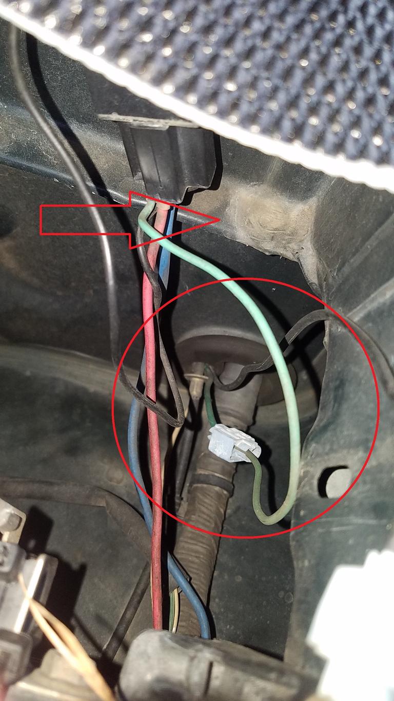

Like many of us, we have run auxiliary cables for power, off-road lights, etc, through the rubber grommet on the driver’s side firewall (see pic).
I have read where others have noticed water in the driver’s side floorboard and often, it is due to water leaking through any additional holes we put in this grommet. (Sometimes clogged drains in the roof but in my case, the drains are all clear) THE BIGGER PROBLEM is the way water drips down from the cowl and DIRECTLY all over this grommet. (See the red arrow on the pic)

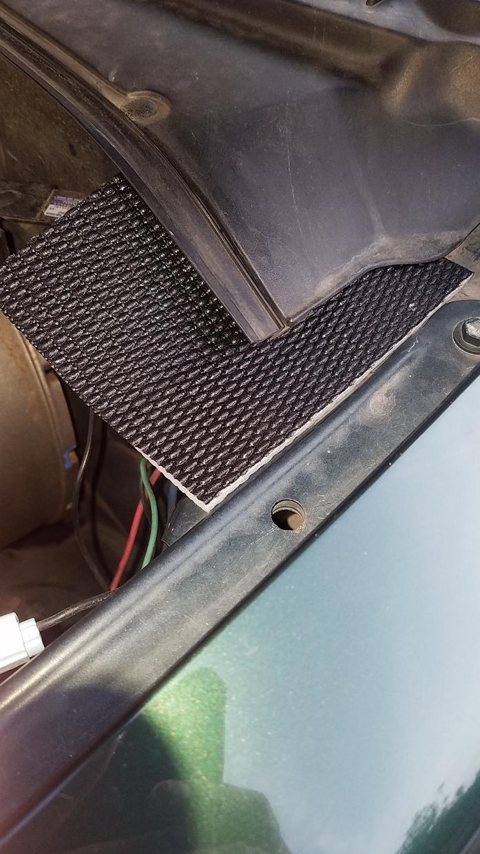

Rather than pack a bunch of caulk in there, on a whim, I took a piece of foam (see pic) I had and made a “drip flange” and tucked underneath the driver’s end of the cowl. (I just wanted to see if it would work)
I am happy to report that after considerable rain storms and lots of water coming down, I checked the floorboard and no water! I knew it was coming through the grommet as I sprayed some soapy water around it and traced it as it ran down the firewall into the passenger side floor board.
Simple fix and the material could be better (flat plastic or metal) but this was just a test. Thought I would share.

Trying this today! I've got a bunch of relays attached right there on the pinch weld above the grommet, otherwise you could possibly attach something there.
This is brilliant fix. Just route the water elsewhere away from the grommet. Problem solved.
Thanks man...no one has ever referred to me as "brilliant" but this seemed like a practical solution to the problem. (Works for me anyways....)
As Little Caesar creeps around all my posts....I will give LiquiMoly the credit....LOL (Just ragging on you LittleCaesar before you rag on me....)
Seriously, as stupid and as simple as it seems, it DOES WORK. No more water in the driver's side floorpan......
