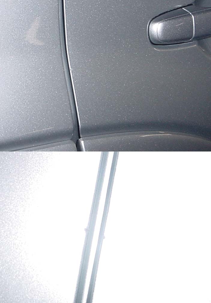

What should I use to fix small chipped region between behind door and body, and the scratch on the left back?
The car is 2004 Sport Titanium.

dude, i'll tell ya this... i had a big ass rock chip on my hood... went to toyota and they gave me the PAINT PEN for my color code... and it did not match at all.. i was so pissed....
my mom's boyfriend owns a company that works with car repair, dents espically.. and they have people that actually mix the paint of your car and inject it in the chip spot with a needle... like used in hospitals... it works awesome... look for somet hing that precise...
I had the same problem and used the pen from toyota dealer and it did not match at all. Anyone here know's a solution?
well, for one, yes, they are supposed to match... but word to the wise... when you use the pen directly onto the surface to be corrected on your truck... what happens if the paint comes out really fast.... your screwed.... so... wanna know how i figured this one out?????
not too happy when i spend 36G's on a new car.. and after a month, i have a rock chip from a cement truck on the highway and they clam no fault when i contact the company..... then when toyota claims that these pens are duplicate color pens.... it looks like bird crap on the spot....
when i used the pen, the paint came out so fast, it rans all over... luckily i had a towel to wipe it up and i had a friend buff the hood... but the paint did not match.... lesson learned, was, put the paint from the pen inside a plastic container and use something, like a toothpick to dab it on with....
a different occasion is when i found out about the inject paint with a needle thing to really get the amount of paint control...
expensive lesson learned...
I don't recommend the Titanium silver touchup paint from Toyota. My grandparents have a silver RAV4 and they ordered touch up paint with the same color code and everything. I went to touch up a spot and it was very dark. I ended up wiping it off and leaving the spot. It looked terrible.
Thanks guys.
So any other palce to get the matching paint.
The trick with needle makes sense, I never belived the pen thing will be as precise and wont leak.

LOL! That is just simply a mild buffing compound. But that is the process, overfill it with the touch-up brush, let it cure, then buff lightly with a fine (mild) compound and blend it right in. Easy to do.

My paint is Titanium, I ordered the touch up paint from Toyota, and it matches perfect. Sure it is slightly a different color while wet, but it dries the same color.

I have also heard that the touch up paint from Toyota does not match. Here is a site I have read good things about. I have not used it personally but there site sounds like they really know what they are doing. You can get paint, primer, and clear coat from them.

The paint (with brush) costed me around 10 bucks from dealer. But no matter how good job you do the color and shade difference will be very visible.
The lesson learned, as long as its very small scratch like mine (and it has gotten to the mettal) go ahead and apply the paint otherwise leave it like that or take it to pro.
If anyone cares I can post the new pic after fix.
the titanium color has metal flakes in it. you must shake up the touch-up paint thoroughly and use enough so that the flakes get distributed evenly. if not, it will look darker than the original. i used LANGKA with toyota touch-up paint and got pretty good results.
