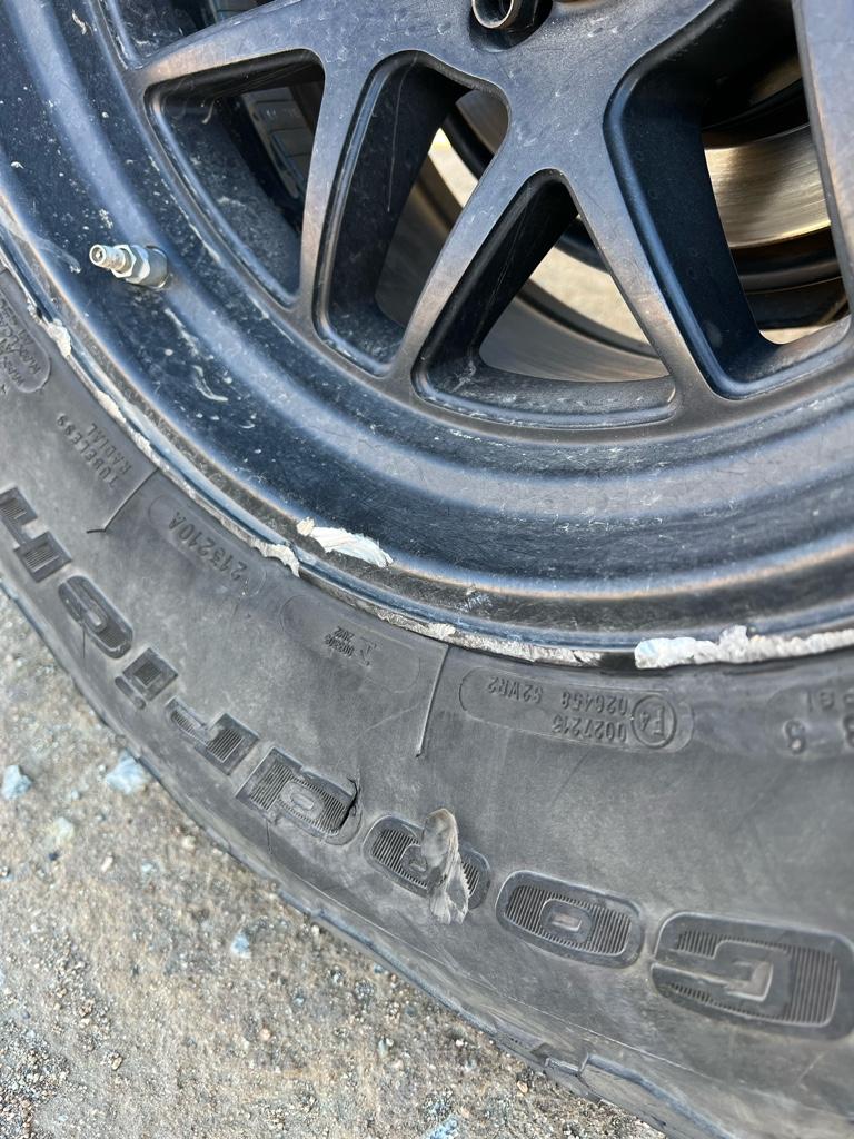

So I’m not usually one to really focus on aesthetics. However, I made the mistake of purchasing black wheels a year ago and after a lot of trail use over rocks they all have significant rock rash. What are folks doing to repair this?
I’m not looking for showroom clean here just passable from 5 ft away. I’ve tried some satin flat black touch up paint but it doesn’t seem to have the coverage I’m looking for. Thoughts?

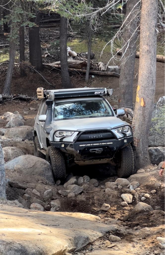

I don’t think tires will matter in my scenario. Sometime I like to squeeze through tight spaces and also use my wheels as a pivot point. Lol

Hahah yeah as you can see by the condition of my rashed up sliders and scratched up bodywork I don’t usually care about trail damage. The rock rash just drives me crazy because it makes me think of curb rash every time I see it.

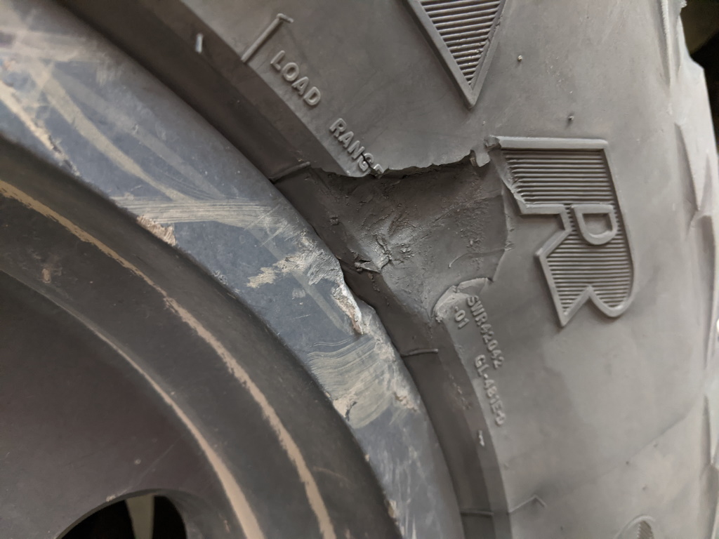

Some tires do have better rim protection than others. Ironically, KO2s have just about none. MTRs had a big thick lip that stuck out like 1/2 an inch from the rim. It does help reduce rock rash, but not this time...
Good call, that would definitely help but like you said it and what we see in that picture it won't stop everything. I have rock rash within the dish of my wheels :lol:
