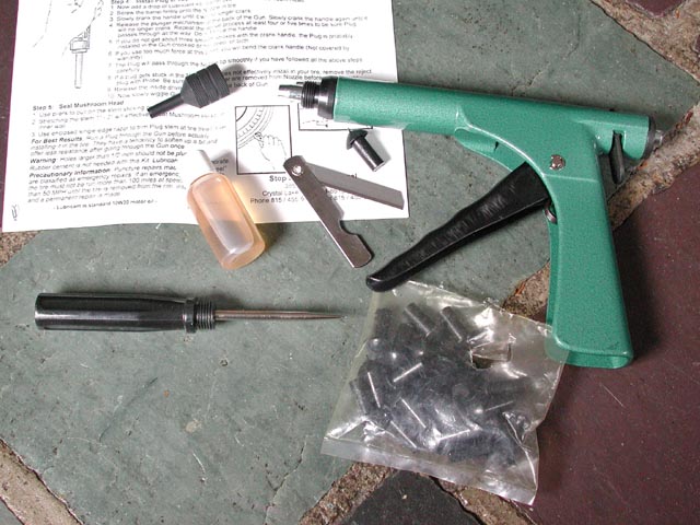

Here is another popular option:
http://www.stopngo.com/Contents/1075.htm
Or better description about its use:
<http://www.zenreich.com/ZenWeb/motorcycle/stopngo.htm>

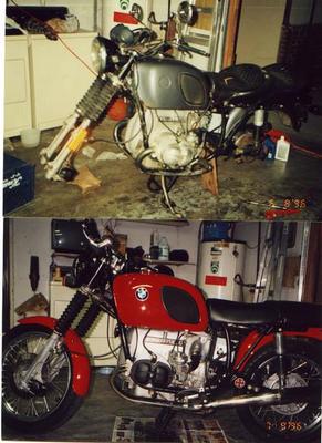

looks like a pretty good kit. hey Lemke, i ride a 1976 BMW R90/6, restored myself! here's a before and after pic:
