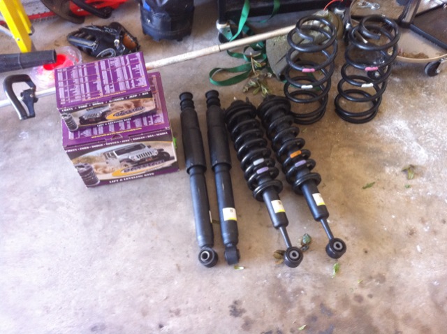

I recently acquired these FJ 4X4 shocks and springs from a member on the FJ forum. Bought the Dayster spacers and set an appointment with 4Wheel Parts for installation this weekend.. Am excited about the install, but I have a quick question. Which spring shocks go where? Thanks in advance for the help

Green/orange is drivers side, green/gray is passengers side on the fronts. I'm not sure if the rears are different, I want to say they are the same and it's only the fronts that are different.
Just out of curiosity if someone were to forget the colors, isn't one of the springs slightly longer and belong on the drivers side which comes from the factory at a slightly lower level?
The drivers side spring is longer so if you get them backwards it will lean to one side. I did this and there was about 3/4" difference, it was very noticeable. I then swapped sides and they are even now.there is more weight on the drivers side so the spring is larger to compensate.
