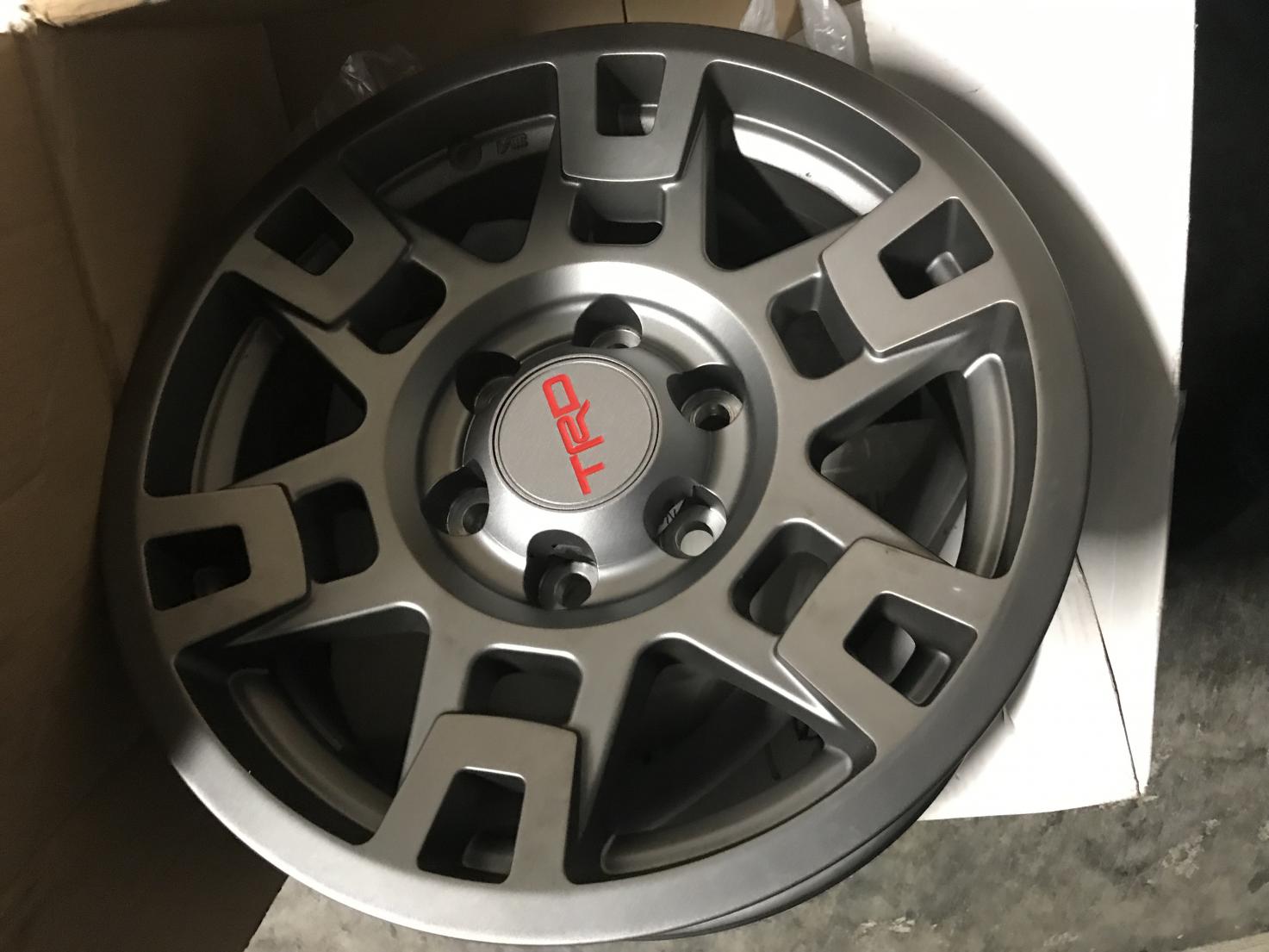

I bought a set of trd pro wheels for my 3rd gen, well come to find out my wife wants them instead. Can they fit without rub on this lift set up on 285/70s?
Lift is 5100s (1.75") and the FJ coils all around. Not sure of the offset but they seller told me they came off a 2018. wheel reads 17x7 stamped

Sorry about that I will edit the post, I am referencing fitting these wheels and tires under my wife’s lifted 4th gen with the current lift set up above
You will likely experience some rub in the front. Why not bolt them on a see for sure where and how much?
More than likely what I will do, just slap them on and see what happens. Wasn't sure if anyone was running the same set up since the FJ lift is so popular. Will take some pics and post on here once I am done for others to see in case someone searches
