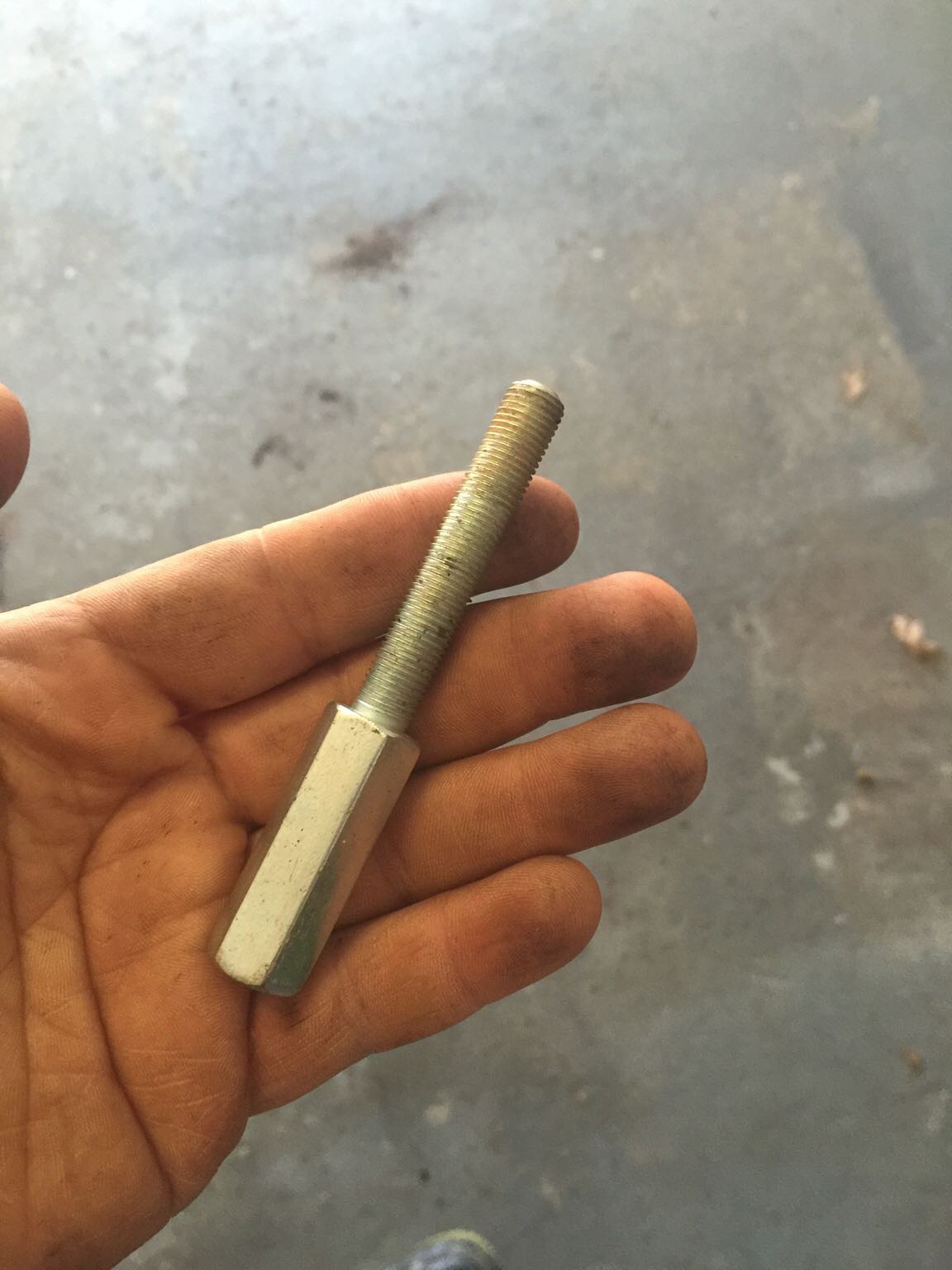

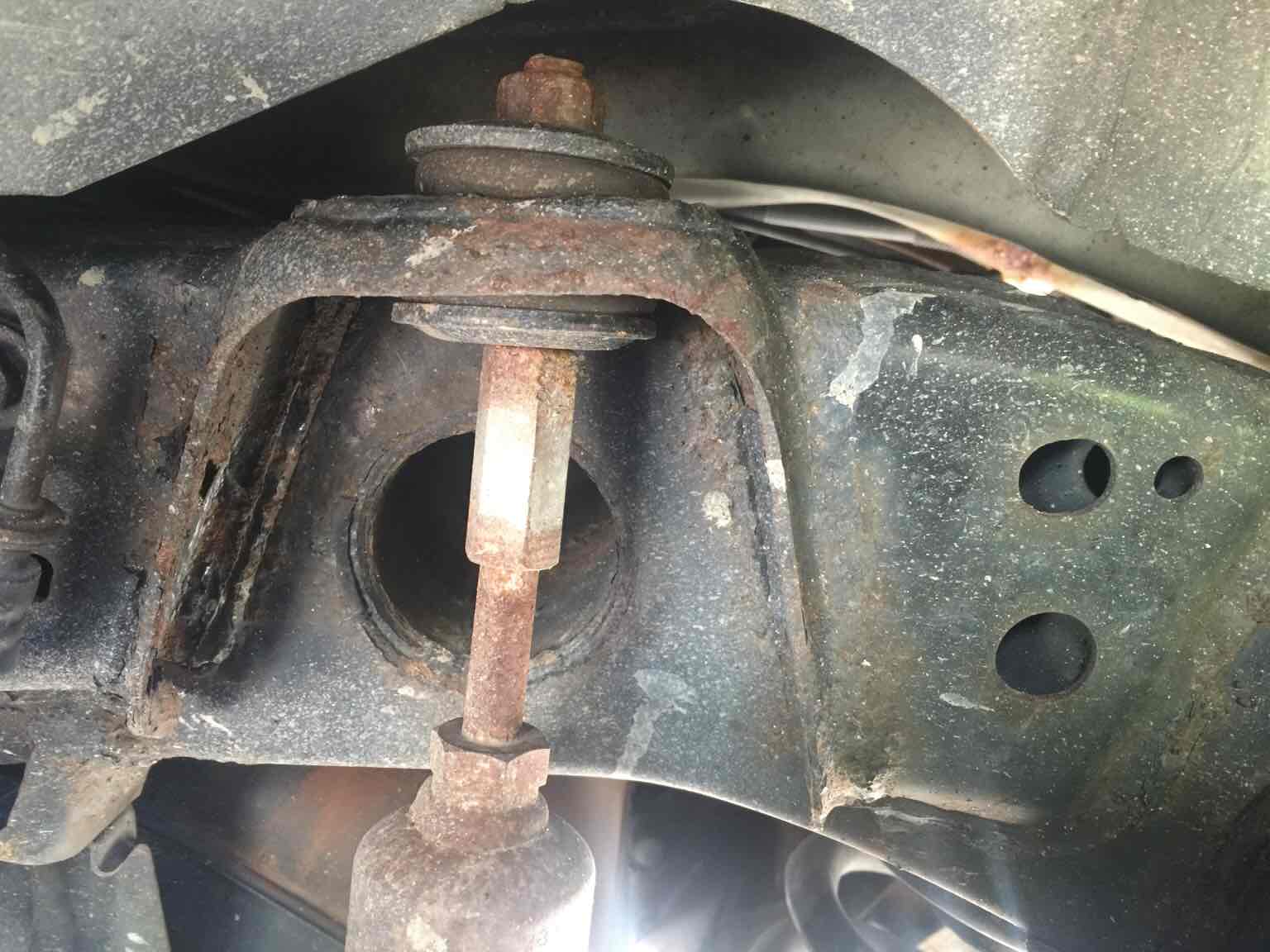

I have a set of the Tacoma extensions I made mine using all thread cut to size and loctited into the proper size nut. Now here's where the tricky stuff happens. You won't find the proper pitch threads and toytec does the same thing as I did. You have to retap the lower half of the nut for the top of the strut to make it work.
