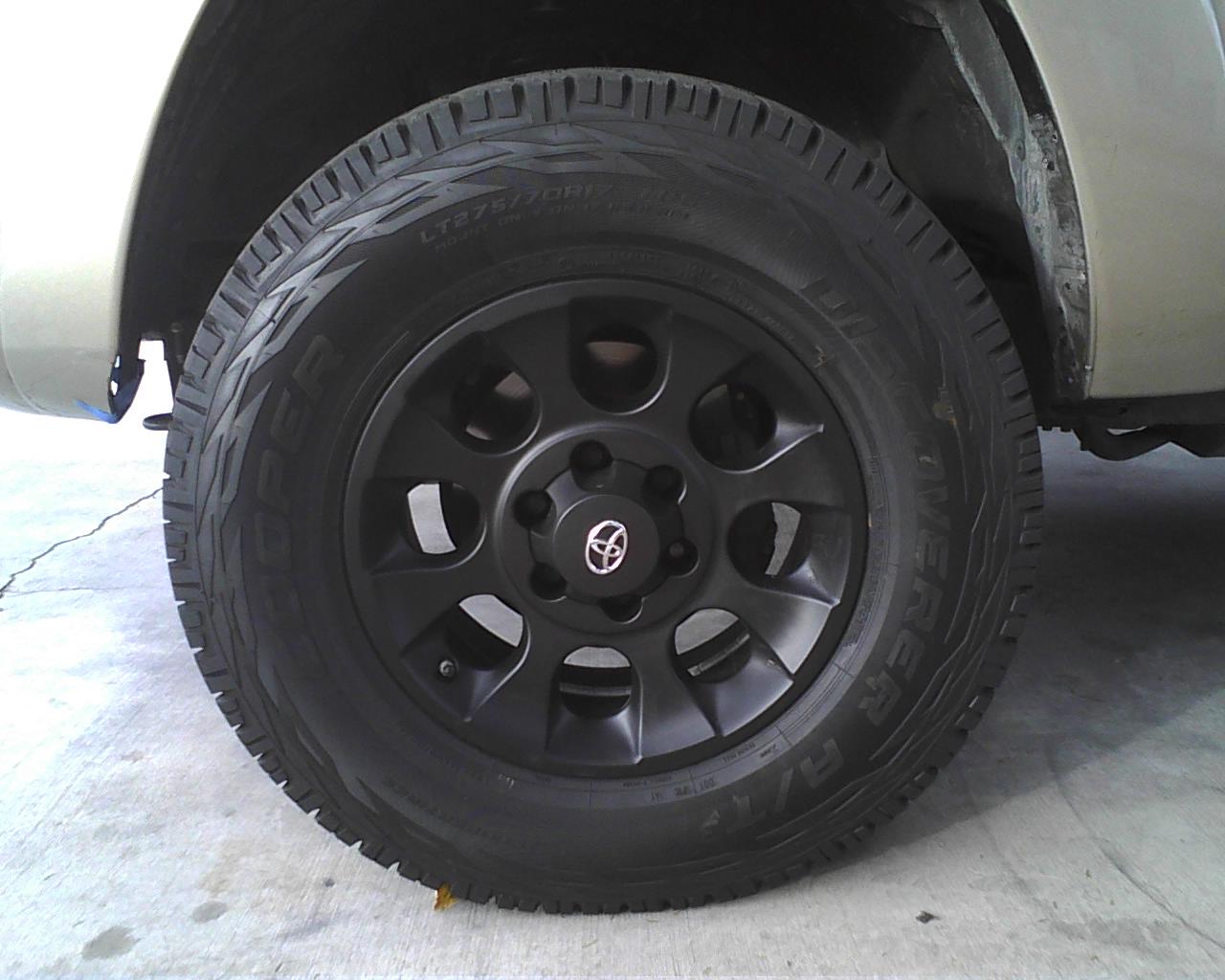

Today I bought rims and tires of a 2013 4runner trail edition with 200 miles on them from Craigslist.
Will be selling the tires and maybe powder coating the rims gun metal and installing more aggressive tires.
So how do these rims compare to the 2013 fj rims?

I believe it goes 17x7.5 on the FJs ? The oem on 4gen are just 7 inch , smarter than me can verify . Offset is correct
