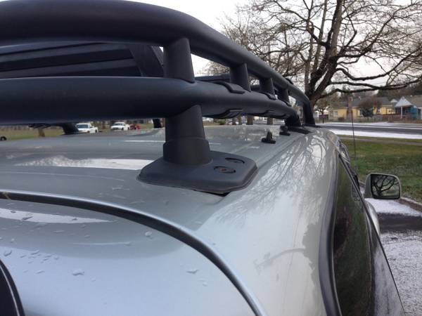

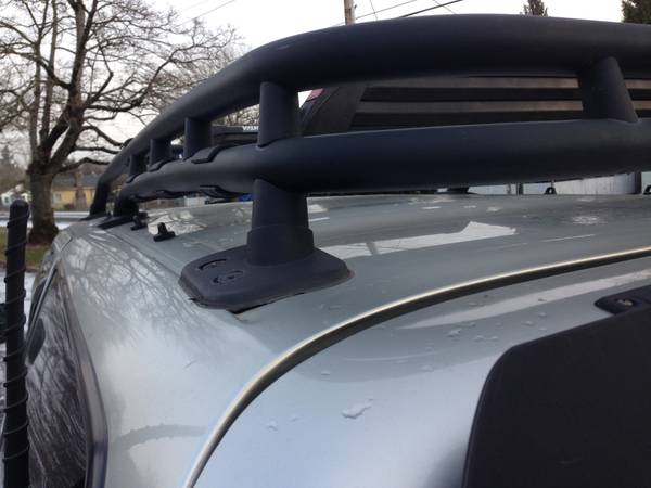

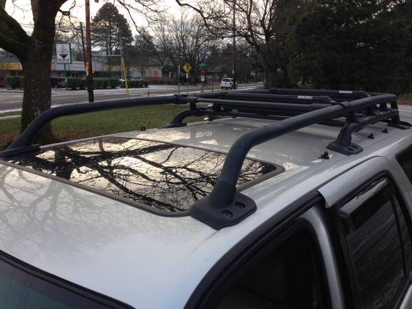

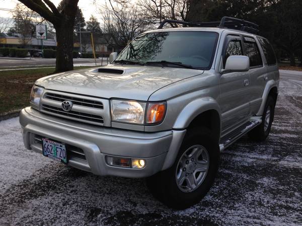

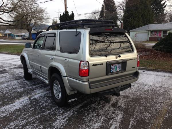

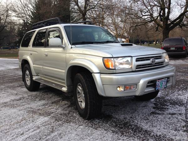

Saw this on "People are crazy" - posted by the kid.

Sir, Got any pics or details of the inside foward mounting, until this I was thinking of "doubling" the oem rails to have a true fastened fwd mounting system for a full length roof rack.
I'd rather not remove the full headliner, but don't want leaks? I wonder what the GOBI/"whizzelstick" fab owners do, silicone the fwd pads down? Does it chatter at speed?

I dont think its that bad, just the tubing is so thick it makes it look bulky. but I think it could be tweaked to look better and be more functional.
