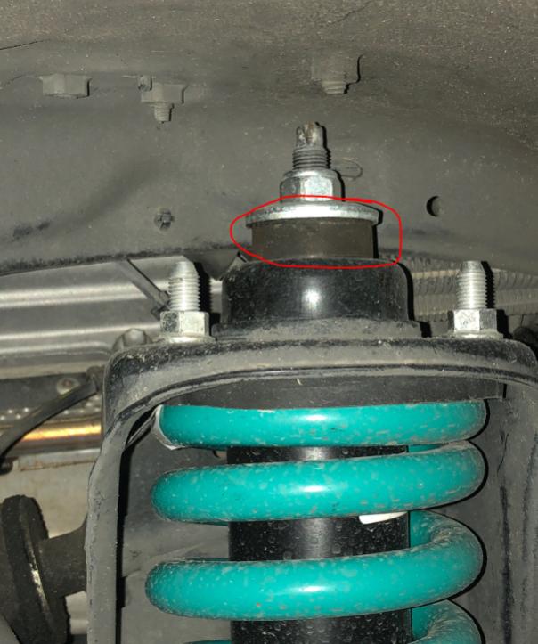

Hold on here. I looked at your pictures and your lower bushing isn't that bad.
I do see that the top nut isn't tightened down securely.
It looks like the top nut isn't tightened down all the way because the bushing and washer are missing. Maybe I can't see it because of the angle of the picture, but OP, do you have the bushing there? Should look like this...
If there is no bushing at the top that would explain why the bottom bushings are wearing out so fast. Good catch.
Yep, it would be moving up and down on the top, why hes hearing metal on metal.
OP.... get us a picture showing the top , move your camera up some.
