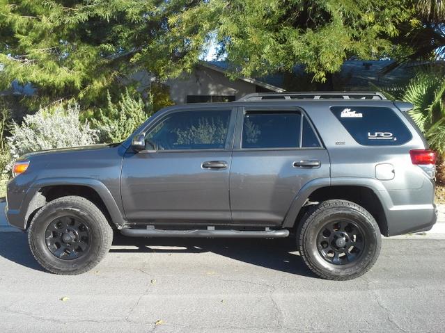

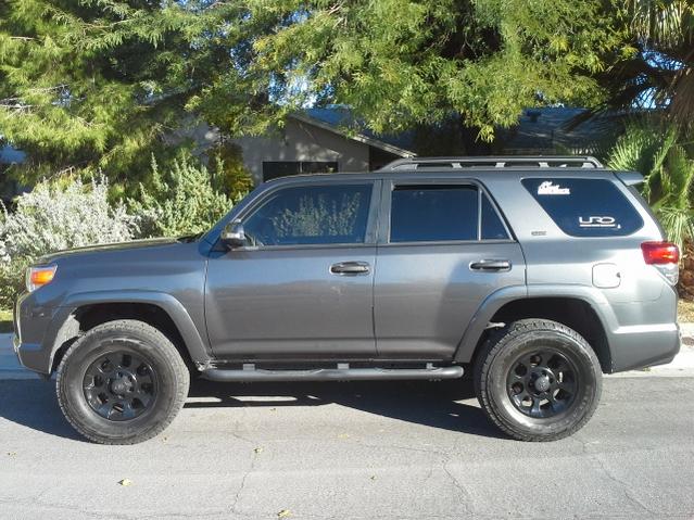

Cpl pics of mine with 14 FJ springs all around with 51s f & r, front 2.5 with a rancho level spacer 1 1/4 in my eyeball says rear higher but measure is 1/2 over with a load perfect ! Got em for free so why the hell not , I did read all that [MENTION=45399]thebwlife[/MENTION] wrote WAY back when also . But it does give the appearance of being a bit taller n rear IDK whatta think ?
Real hard to tell without a tape measure in the pic, but it does seem to be a little bit higher!
Cheers!
Actually went back out after taking those & it was 1 inch more in rear so their taller for sure ! Gonna jack it back up make sure in correctly ! WTF
