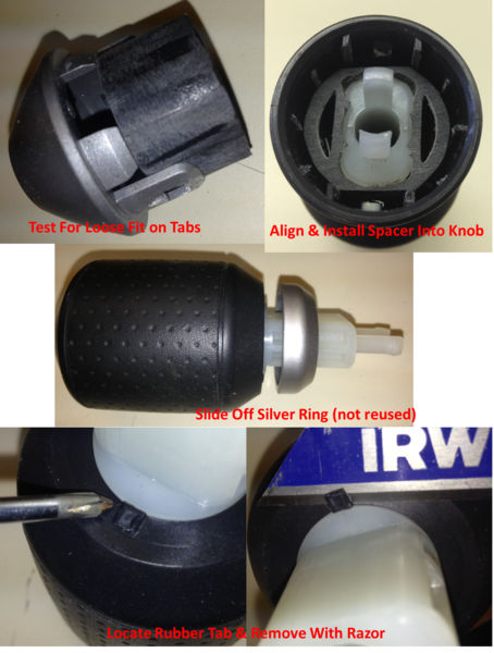

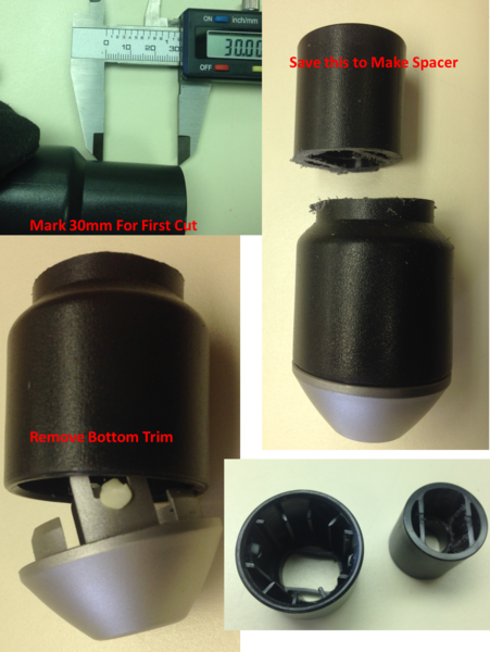

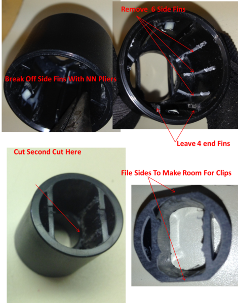

I did one a few days ago for the 5th gen guys, and I wanted to show love to the 4th gen guys. It's a time consuming mod, but it really does look good IMO. However the 4th gen OEM knob does not look as massive as the 5th gen one to start with.
