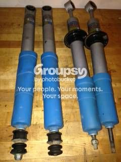

5100 Bils vs Stock (TRD or TT or ?) silver/blue FJ Bils.
Valving? Collapsed/extended lengths?
I get that the 5100 Fronts are adjustable height, but that is essentially just spring preloading. I guess I'm more concerned with the extended lengths of the 5100s vs these, as I'd hate to save a few pennies and loose some potential shock travel. Anyone know these specs? Pretty nifty deal on CL near me for 4...

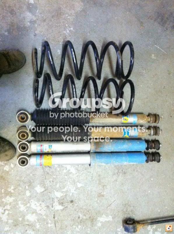

looky what I stumbled on:
difference in mounting points is really minor, doesn't actually look like a full inch in this pic...
Looks more like they're fully extended?
I didn't buy them, I just found a pic online of the 2 side by side for comparison. 5100s look a little less than an inch longer than TT FJ Bils. A touch less droop to be had with the TTs.
point is you can't tell exactly how extended the shock is... I'd go with what bilstein told you.
