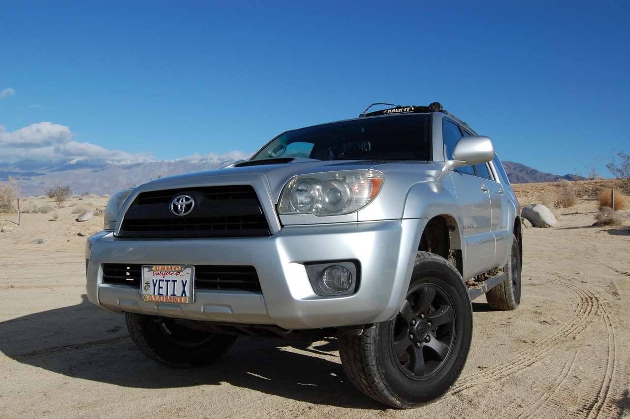

I had to set fronts to 1.75" and 1.5" spacer in the rear for level. Some others did this too. Without the spacers, it had some rear rake based off the running boards.
Do you have any pics? I have 5100's sitting in my living room. Debating sticking with .85 or going your same route. I was figuring that the spacer in back could be smaller...?
The stock running boards have a slight angle to them, so with the forward rake, they're level. Without the spacer, the rear end looks low because of the boards.
Dang.... I really like the look of that. Looks a lot more fun than a boring .85 up front.. What brand of spacer did end up going with?
It's the 3rd setting in front and Daystar 1.5" in the rear. AC Delco FJ springs front and rear.
