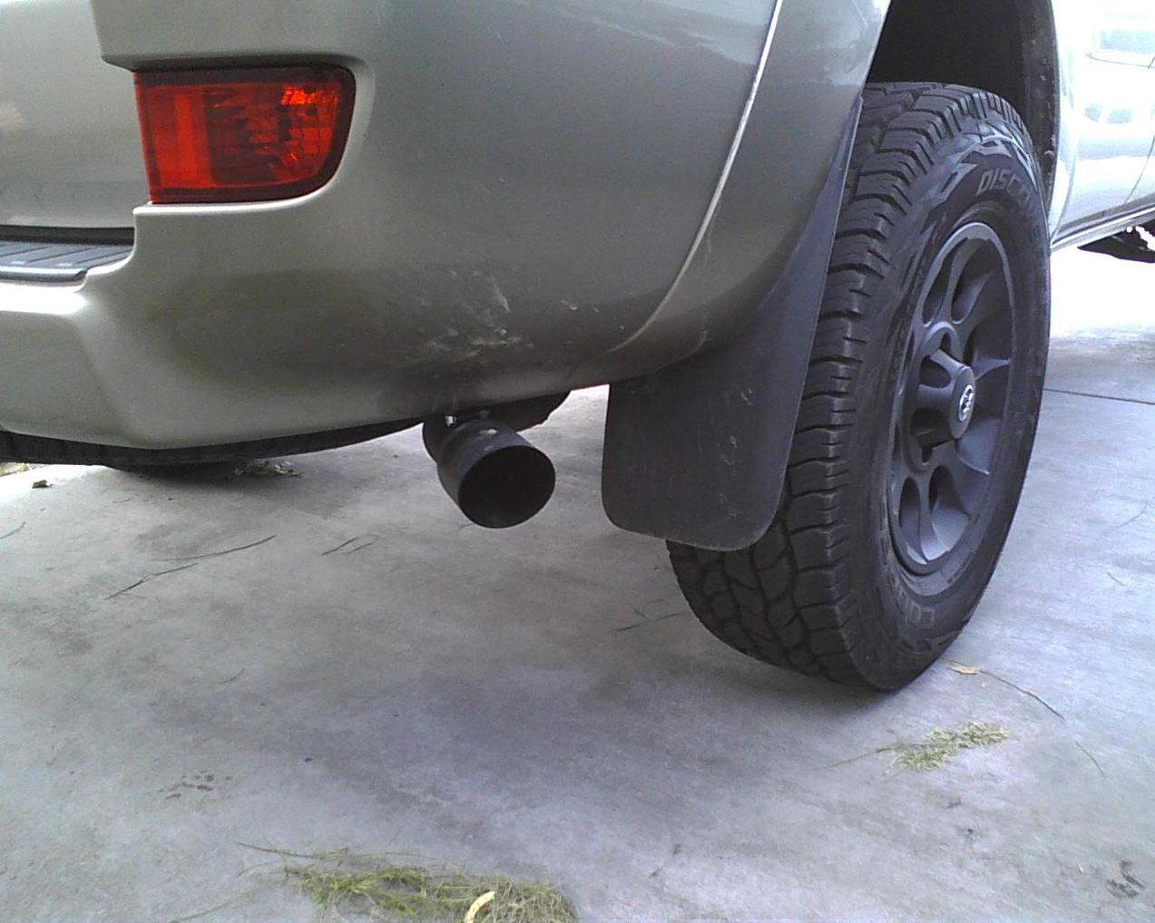

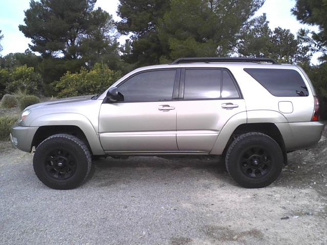

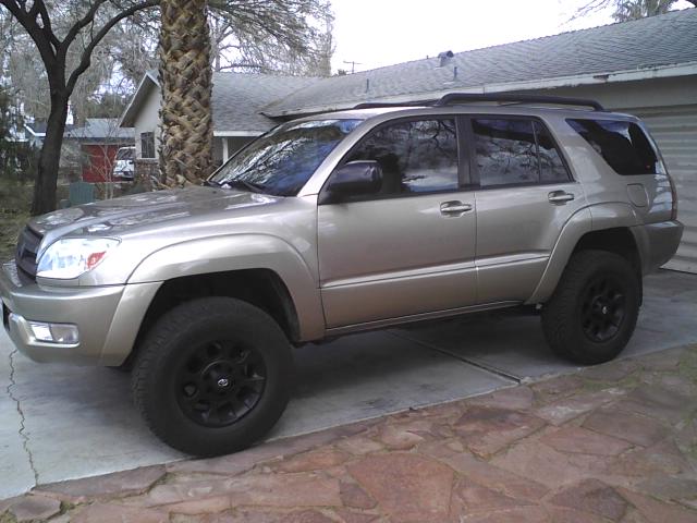

pc-d fj wheels
These are mine , what's the big deal here they fit !!!!!!!!!!!!!!!! :bigok:
