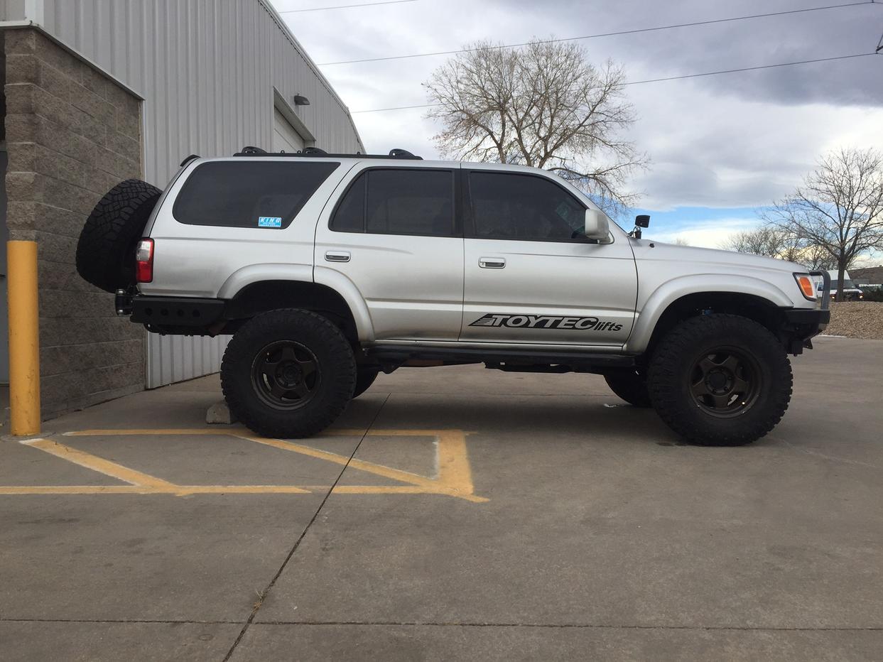

I'm on year 3 of my superflex rear coils. Rear bumper, full spare, subwoofer, + tool box. I still have 3.5" of lift.
I've NEVER recommended the bold statements highlighted. Not sure how much your set up weighs....seems to be a LOT.
Interesting claim. Did you happen to record your before and after center hub to fender measurements?
