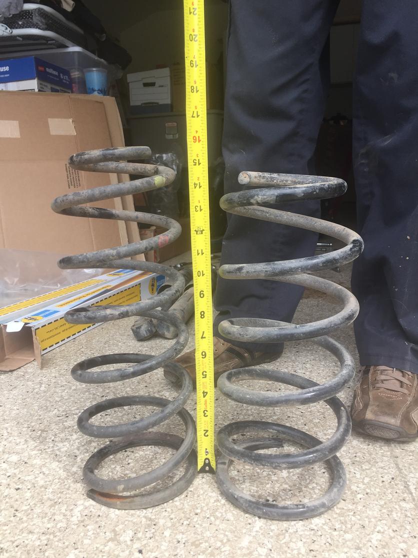

there was a post in another thread that the rear coils give a slight amount of lift but can't remember the lift amount, iirc, it was somewhere between 1" and 2".
if you decide to get the stock setup, could post the compressed and extended lengths of the rear shocks as well as the part number?

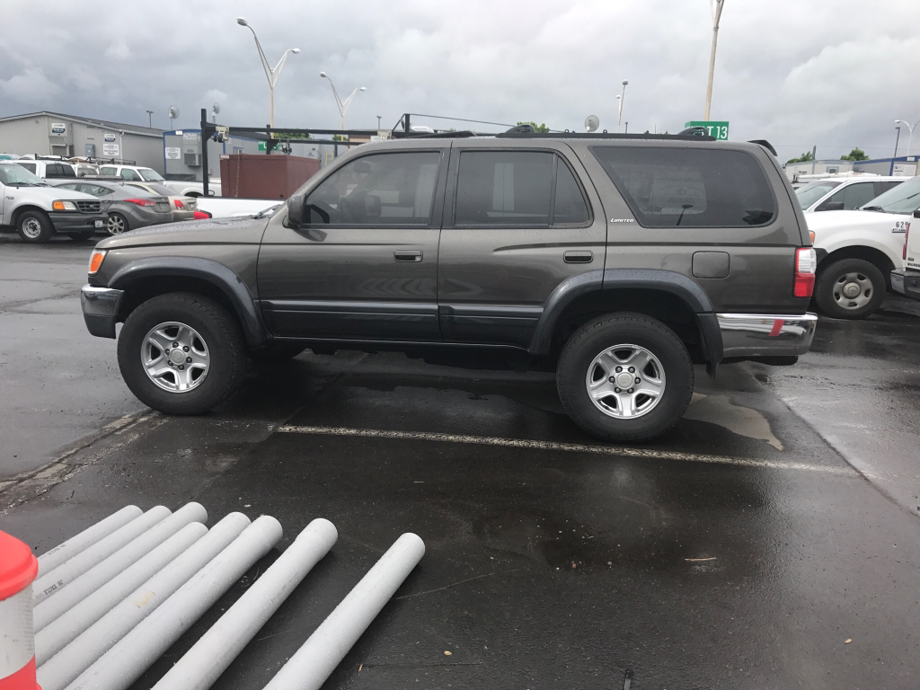

Might be one of my posts you're thinking of. It gives 1-2" rake, and handles AWESOME. [MENTION=155898]Hoffie[/MENTION] I fully recommend the 5th gen rear coils for the rear of a "stock" height 3rd gen. The shocks may be a little long- you would have to put the shocks on and go full-bump to make sure the shocks don't bottom-out before your bumps hit. Here is my '97 with '14 rear coils(stock '01 front suspension)-
The driveway slope might encourage the rake a little. It sat a little less raked on flat ground. Super good setup for the occasional camping trips and utility trailer towing without riding on bump stops like the stock coils would be!

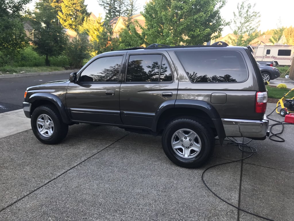

Isn't it horrible?! I don't know how anyone can drive a 4Runner with clapped out coils like that. When I got my '01, I drove it around the neighborhood a few times. Just driving around the neighborhood, I was certain someone had swapped out the coils for wood blocks. Weird part is, it didn't even look like it sat them at low! But looking under it, there was only about 1/2" before the progressive bump made contact with the pad on the axle. I think you'll love the 5th gen rear coils. I had the stock '01 Tokicos paired with them, and it was great.
Regretfully, I never even took good pictures of the '01 before I swapped the suspension from my '97 onto it, but you can still see how the rear didn't seem to sit too low.
To me, this looks not too saggy, but was HORRIBLE to drive-
