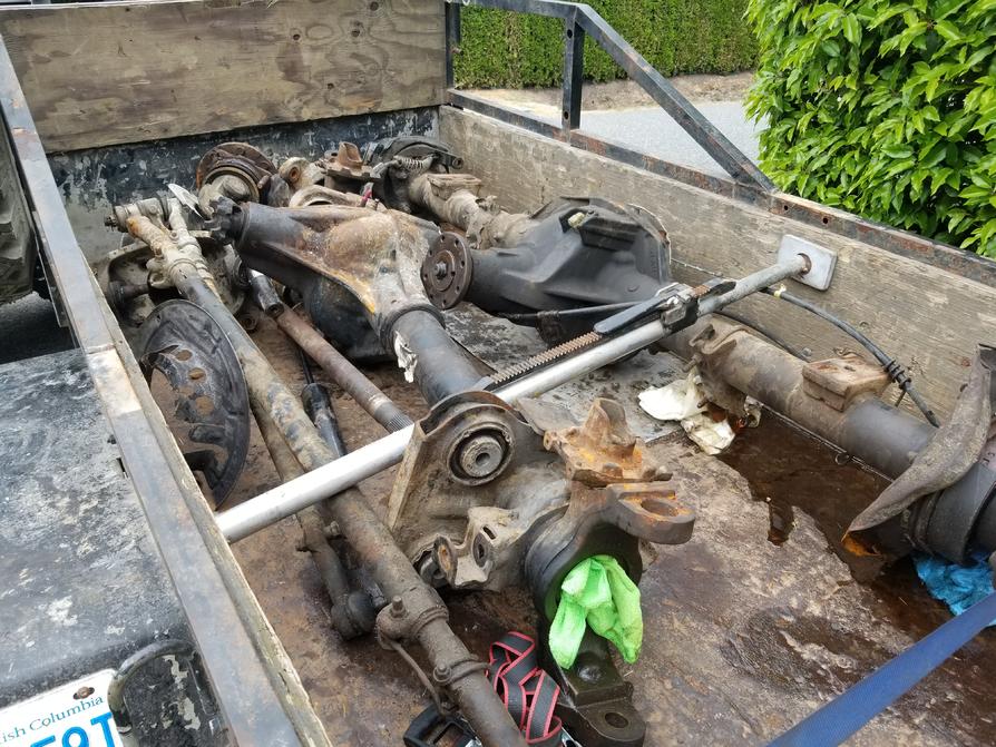

Change of plans bought a d60 front and sterling 10.5 from a 05 Ford
