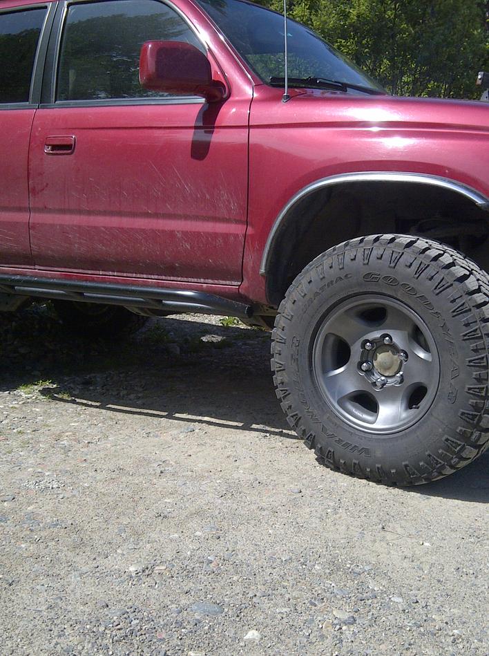

pics are always good when you do something to your runner, cuase we like to share the excitement with you. :driving: here is a pic of mine minus the caps
