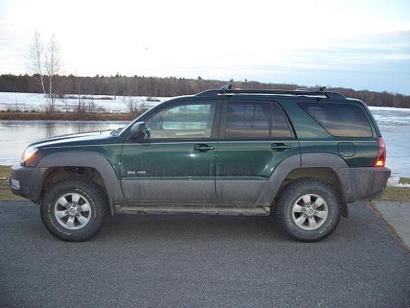

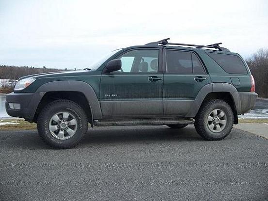

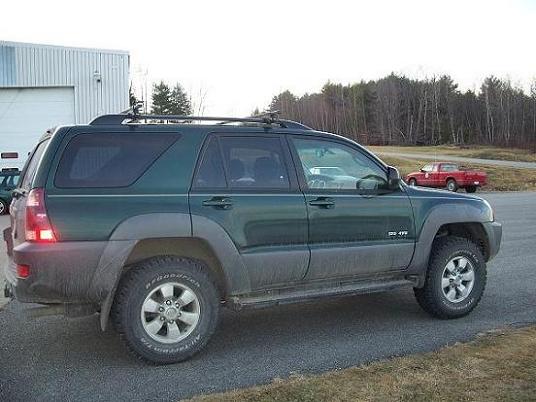

Here are some pics of my "lift". Hope you like it. I think it looks pretty good for the price and the only noticable ride difference is the lack of body roll in the corners.

I put FJC springs all the way around. The rear was raised 3/4" when measured thru the centerline of the tire. The fronts were raised about 2 3/4" measured the same way. It is a little more than expected but I am not pulling the front end apart again unless I am installing new shocks. :bash: It depends on when I look at it whether the front is now higher or lower. So I think that is pretty close to level. I am VERY happy with the outcome. There is little to no body roll and the ride difference is minimal at most. I have zero complaints from the wife which says alot. She did actually say it looks better and she likes it.

Looks really good. I see what you mean about the front being nose high . At certain angles it looks level , different ones look like back up slightly.
You mentioned the spacer and where you put it . Do you think you put it in a different spot than others , it blots up to the top plate with the rubber gromet between the spacer and the spring to my knowledge unless Im wrong.
That is where i put it. in between top plate and rubber bushing. I was under the impression some spacers go in a different spot. not sure about this just thought there was 2 different designs.
