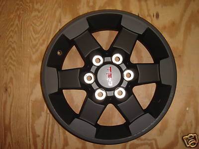

I just about wet myself when I discovered these...matte black TRD Trail Team Edition Wheels for the Toyota FJ Cruiser.
Those are sweet! I have a feeling that they would cost allot more then the ones local here. I am thinking that if I am going to go black that I should just get some FJC 17" steel wheels or some simple after market ones to save the expense of powder coating.

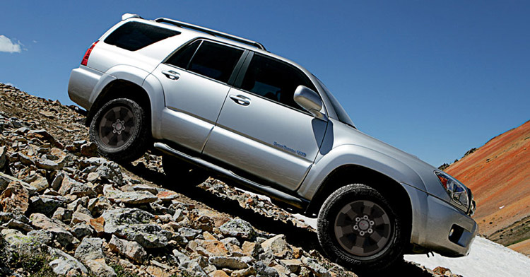

How did you get 16's to fit on a sport edition ?
Falls said:
Those look excellent on the Silver !!!! Nice choice .
Dang I love that Titanium Silver !!!
It was tough but I first had to install something called Adobe Photoshop. Then the rims went on the truck just fine. hehe :bigok:

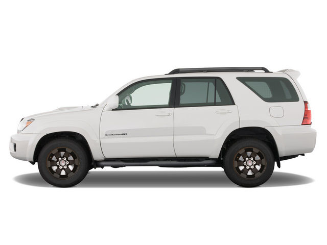

They don't look too bad on white either..:cool:
