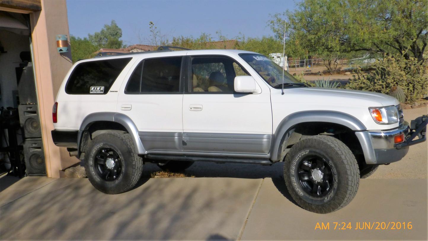

Are the sport flares different from the flares used on the Limited? ('98 for me).

So was I wrong in this then??? I knew the Limited Flares you had the square holes in the body that clips went into... I thought I read (and it was ages ago) that the sport flares bolted on just like the cheesy SR5 chrome ones did (by little screws from inside (or underneath on the lip) the wheel well).
But I'm reading on this thread that the Sport Flares require drilling as well?
Yes,. Sport are a tad smaller and Black. They're between the SR5 3/4" Chrome Flare and the Limited.
The 99's (and maybe the 2000's?) used the smaller black flares. 01-02 used the same wider SR5 flare. Which is slightly different from the limited flares. The base at where the flare meets the running boards are more flat on the limiteds whereas on the SR5/Sports they are rounded. The limited flares also have a cutout to accommodate the additional body cladding.
I'm not crazy about the Limited flares, they look like they take up too much room in the fender well and limit tire size...maybe that's why they're called Limited.
99-00 Highlander flares are the black one's & 01-02 are like the Limited but a little smaller & dont account for the cladding. So yea, if you want the OEM 01-02 Sport it will take some time.
