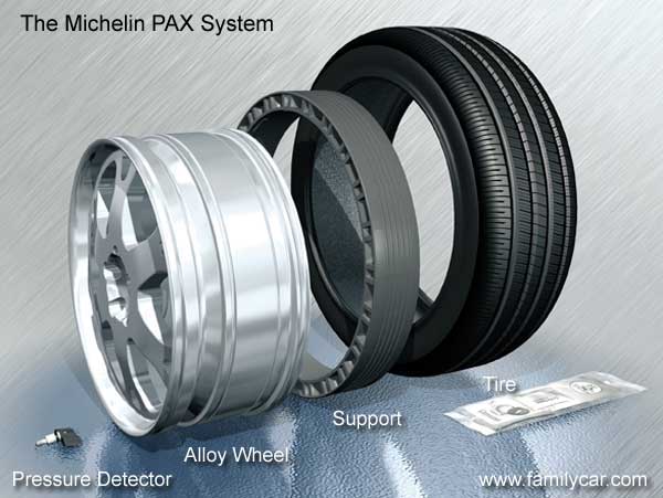

Talk about a PITA tire. When visiting Bobby at his shop we were talking to a service rep for Bobby's new tire machine (amazing machine). He told us about his experience with the new Michelin "PAX" tire system on the Honda Odyssey. How about a tire system that uses special rims, can only be repaired by an authorized mechanic, on a special machine that only the stealer has. They don't even have snow tires available for this system. Talk about STUPID!
