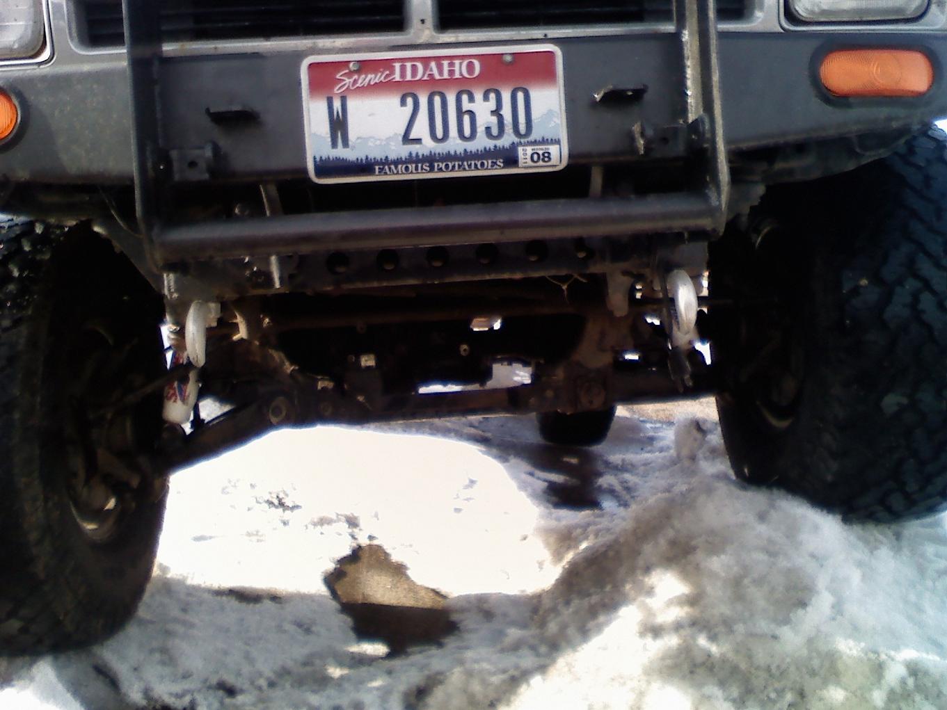

if you look really close there is a metal tab in the middle of the bumper inside the 2 uprights, there is a whole that goes all the way through. i have a u haul pulling system that goes into the tabs and i just put a pin through.. haha if that makes sence. i welded them in so they will always be there.
