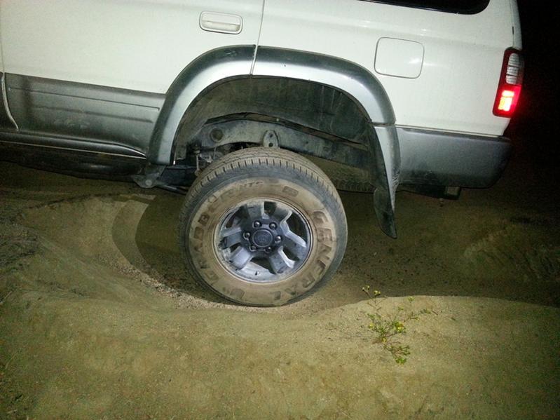

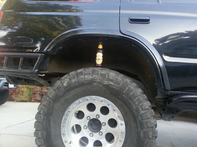

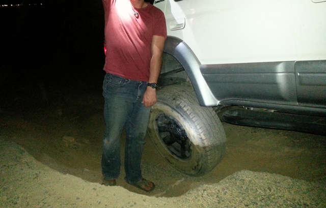

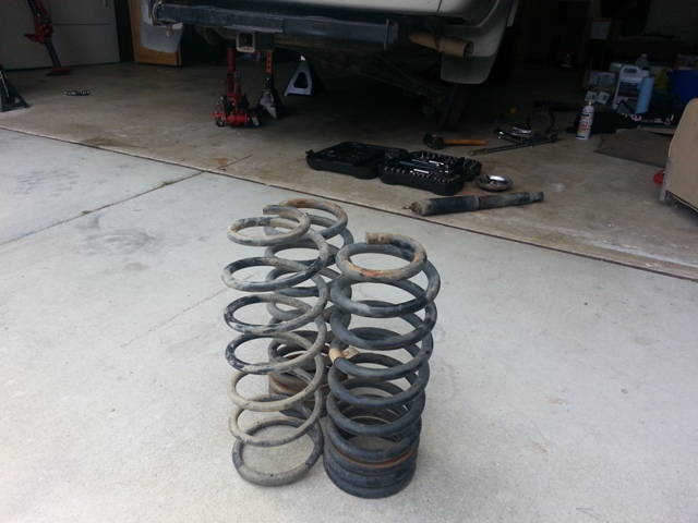

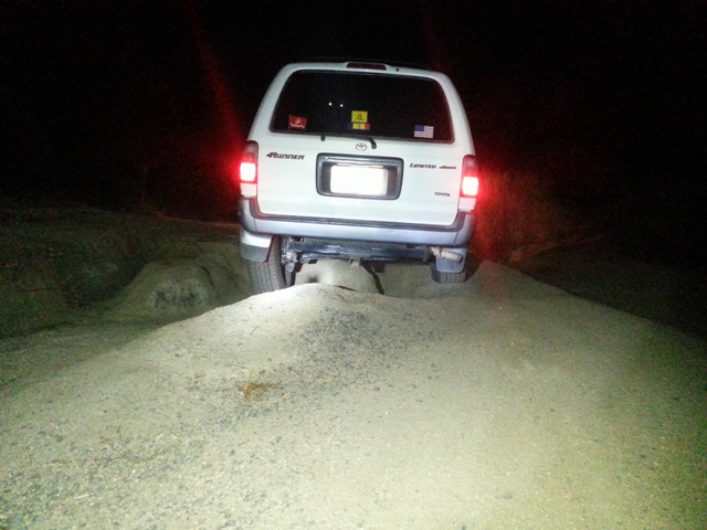

Well the time has come to change springs in the back. Thanks to Kraze and a few beers and pizza. This was the end result of today's work. Last pic is of Kraze's truck with the 8 wraps. It is TALL, and yes those or 35's also.

Couple things to note. The '99 tall coils, when uncompressed, are actually a good amount taller than the 906's, but we were still able to gain a solid 2 inches of lift, even though the 906's had been on my 4runner for 100k+ miles.

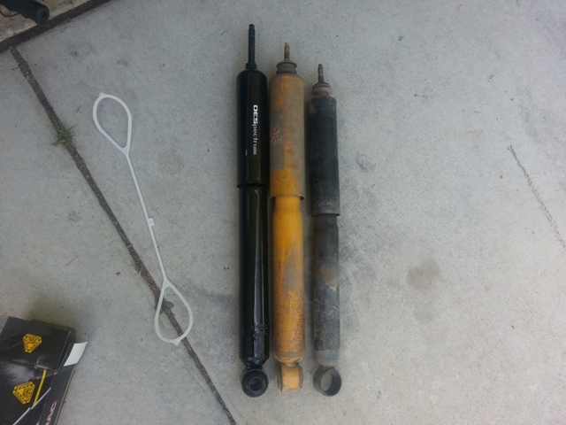

In a pinch, a 4th gen OE style replacement shock actually works pretty well with 906's.
