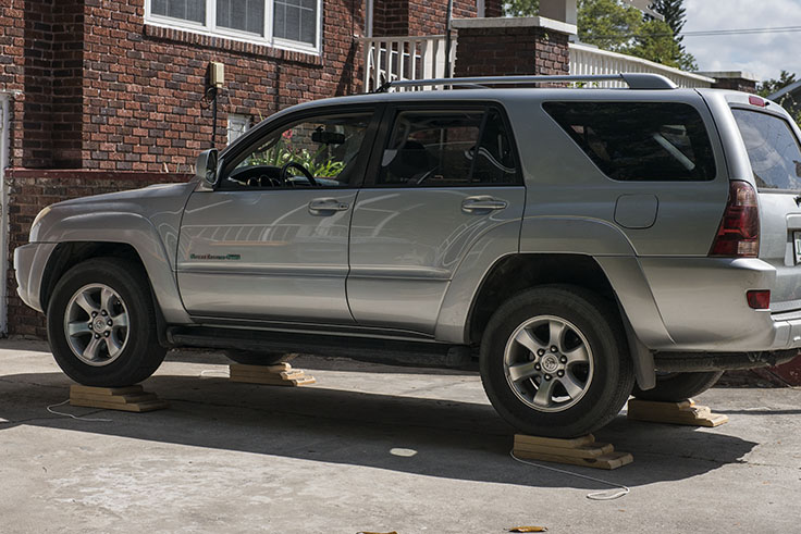

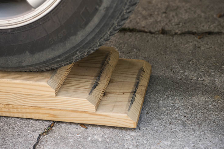

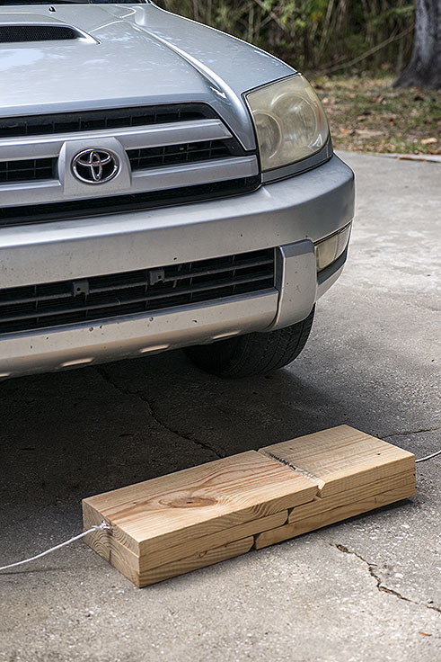

not quite a floor jack but ......
This is only possible using 4 wheel drive low.
I hope this isn't to far off topic. I have a bad spine and jacking my t4r up is pretty much undoable. however, these give me the capability of doing some maintenance and keeping repair bills down. Lying on my back and doing work is much easier for me. They also allow me to get a little higher in the engine compartment when doing maintenance, I do this by turning one upside down on the other.
They add an additional 4 1/2 inches so my belly will fit and it doesnt seem like a struggle under the vehicle.
I use the rope to drag them so I don't have to carry them.
And no, I am not afraid of them they are very sturdy (please use in gear only with emergency brake on) . And don't forget to move them before backing up to far.
They are glued and screwed.

Thanks, cost is about 25 bucks and home depot did the cutting for free (except the angle cut). Obviously you cant do any work with wheels but very easy for everything else as long as people use emergency brake and also do not drive to far forward. It would probably be safer with some sort of 2x4 stop in the front.
