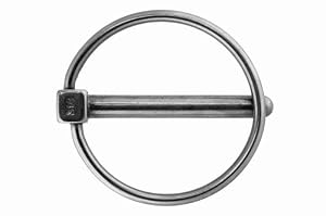

Crawl under and remove the nut holding the 4wd linkage on the drivers side, i think it was 13 mm. Ant the tranz linkage on the drivers side, its a tight spot, mine had a snap ring, that i wouldn't think is original.

snap ring pin fit tighter in the new bushing, and its a tight spot if you dont have a body lift, just go with a snap ring.
