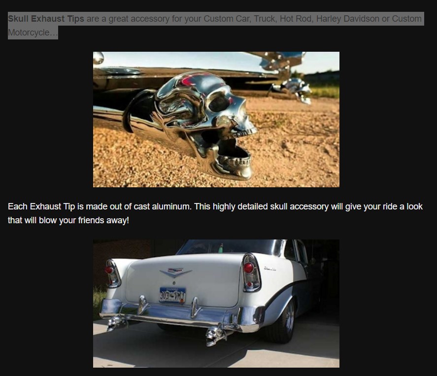

Throw one of these sick skull tips to complete the transition....its supposed to "deaden" the droning noise
