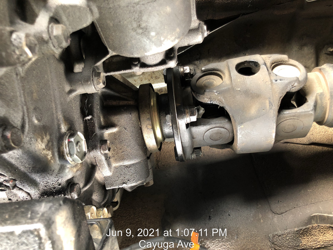

It was a rear driveshaft front yoke with worn splines allowing driveshaft to flex at high speeds along with a super-worn super-non-lubed u-joint. I take it on the freeway and it purrs like a kitten! Yay!!!

Interesting, what companion flange yoke did he replace it with, Toyota quoted me $396 for #33309-35091..., tempted to try one off my other parts 4Runner but it’s probably a ball of rust or no better.
It was a used Toyota OEM part (I double checked with him). He showed me the worn out part and you could see some of the splines were erased looking almost. 318,000 miles on the original part though -- not too shabby.
Here's a pic of the part after the fix -
