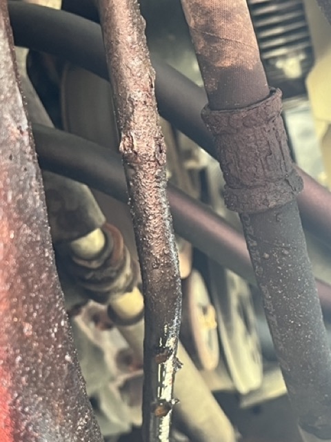

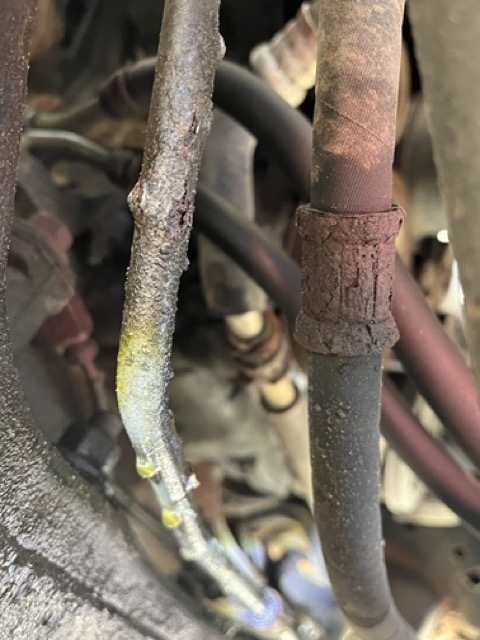

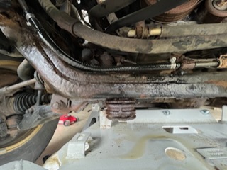

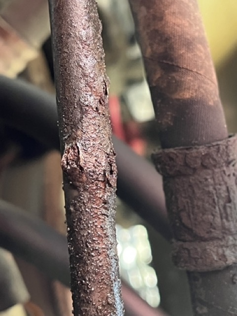

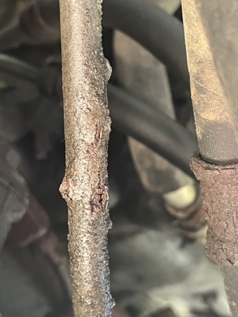

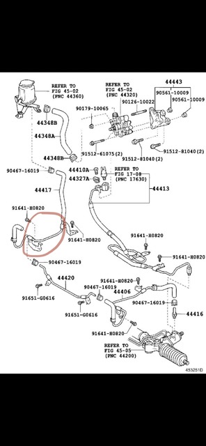

I've got fluid leak (power steering) as well and couldn't figure out why it was all over the place. didn't think about the radiator fan blowing it all over. I'd suggest taking at look at the power steering lines. Here's where my leak was. just tracked the lines until I found fluid everywhere inferior to that location.
any input for a similar issue?
2008 4 runner with 150K miles, michigan/rust. keep having issues with power steering fluid disappearing. this looks like source of leak. its all over this side of the vehicle presumably from radiator fan. agree that this looks like a potential source? anybody have any experience replacing any of these lines?

If you have good solid line on either side of the rot, cut rotted portion out and put in hydraulic/power steering hose from NAPA and hose clamp it. Did mine and it's held two years now.
Appreciate that idea. Complete newbie here. any suggestions on what to use to cut the line? Sawzall with a fine blade? assume I have to bleed the fluid in there now out somehow.
[MENTION=741282]StonePA[/MENTION] - search on YouTube, there's at least one how-to on replacing 4th Gen 4Runner PS lines.
I did the same on mine. Simple enough and fine after a few years.
Sawzall will make a mess. Simple hacksaw or a dremel with a cutting disk works. Also can use a plumbing pipe cutter. The system self bleeds by turning the wheel lock to lock assuming you keep the reservoir full.

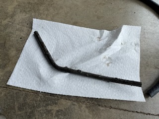

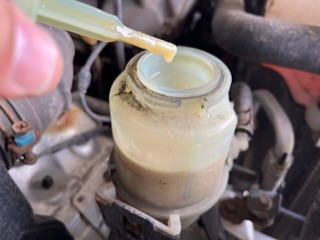

Cut the rusted section out and replaced with 3/8 tubing. Turned wheel back and forth several times with engine off. Then with engine on. These is air in the fluid…turned milky brown with bubbles. Suggestions?

Generally means air is in the line. But, that is milkier than normal. I would flush it and check it on a frequent basis for the first 100 miles or so.
