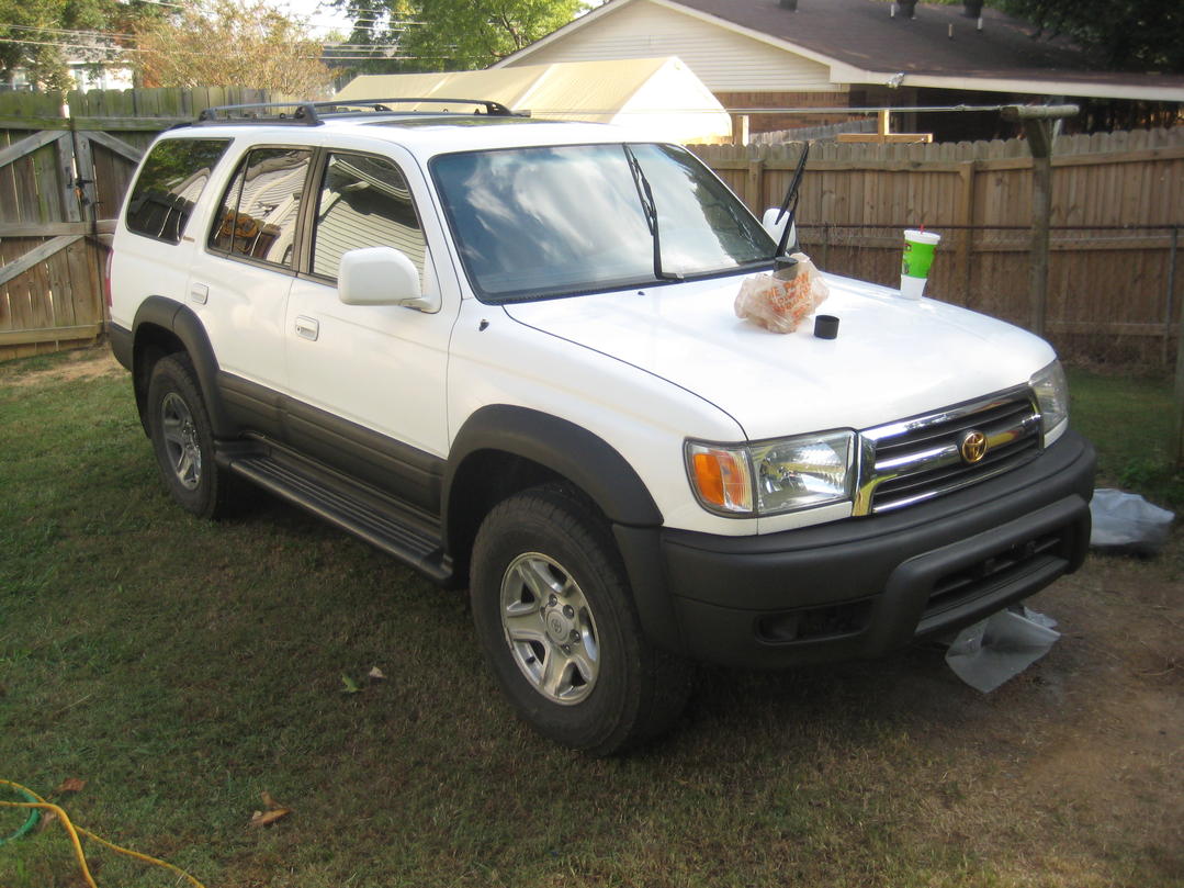

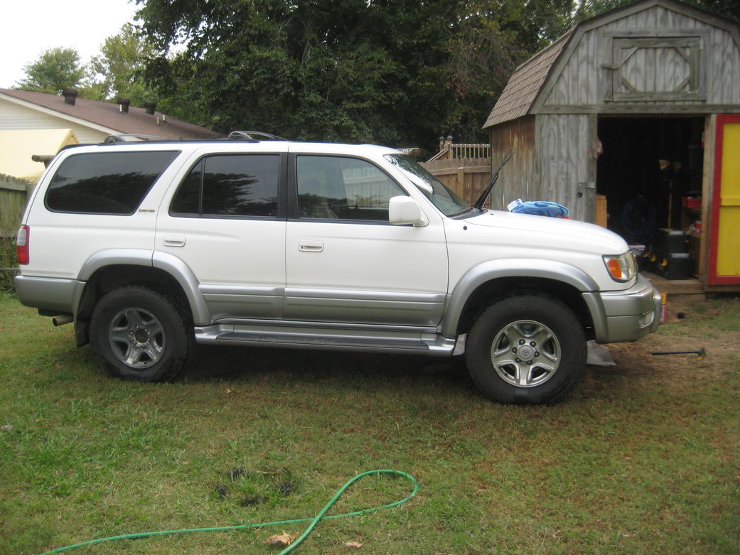

Issues: The front driver's seat looks like Freddy Kruger fought a saber tooth tiger while trying to drive. The rear axle seals have leaked since I bought it. I tried replacing the seals once to no avail. I have all the parts to completely replace the bearings and such but haven't got around to it. Valve covers leaked a bit but I stopped this by torquing the valve cover bolts, which were remarkably loose. I plan on replacing that gasket now that I'm keeping it. The front steering at low speed and close to lock has been groaning a lot in the past few days. I fear LBJ failure. I'm going to check out the play tomorrow but I'll probably replace either way. They are leaking a bit and, I suspect, going dry. The clock doesn't work, which this is the replacement clock I bought to replace the clock that didn't work. The center vents are damaged, there are exterior flaws including a couple of small dents and thrashed wheels. There is heavy rust on the exhaust but the rest of the truck has only light rust spots.
Like I said, I haven't given her much love because, for the last few years, I didn't intend to keep it. But she's done a great job towing, performing DD duties and mild off-road functions. She deserves better.
Oh and I painted the cladding, fender flares and bumpers black, but I still hate them. They gotta go at some point.
When I took the running boards off with the skinny chrome flares still around the wheel wells, I noticed a lot more rock chips on the sides of the doors so I got a set of Limited flares and cladding and am currently putting them on. When you take off that cladding you are going to have big holes in your doors, and everywhere else under the flares.
Ya, I'm still trying to figure out what to do with the holes. I've seen a couple of interesting approaches - One was to use a painted and modified plastic plug to fill the hole. Another just did a fill weld, although I'd worry about warping the sheet metal with this. I've done a bit of welding and even short welds on heavier square stock can result in warping from the heat.
I've been thinking about a method using fiberglass. Attach a fiberglass patch to the backside of the holes (with resin). Once that is cured cut a fiberglass square and use resin to stick it into the hole. Sand, metal glaze any remaining imperfections, sand some more, then it's ready for paint. But I don't know if I can access the backside of all of the holes yet and I'm not sure how to keep the fiberglass patches stuck on those vertical surfaces while they cure. Maybe I can temporarily tape them, but I'm worried about all the resin running down off of the patch. I can also just fiberglass over the outside and blend in those areas if I get lazy. I don't know, I'm open to ideas.
I'm just so sick of the cladding. Those little clips break off and then pieces come loose, plus I have sections where the rubber seal is partly coming off. There's a lot to do to make it work, but I think it will be worth the headaches.
