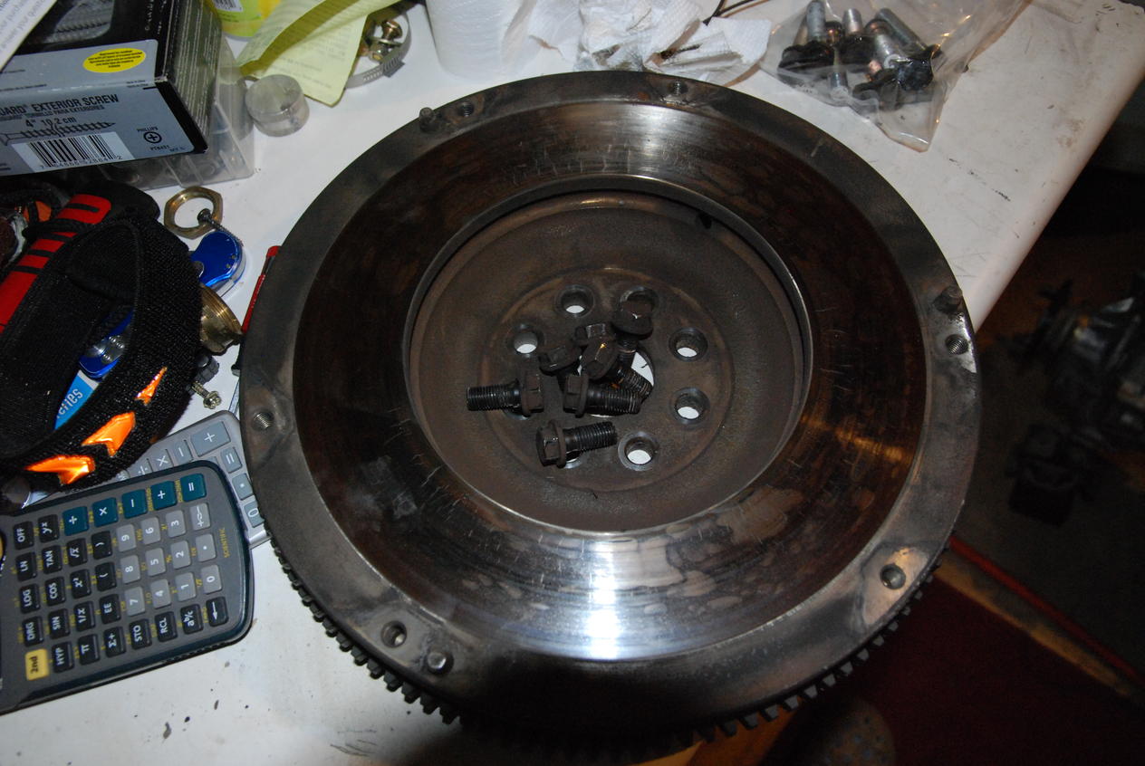

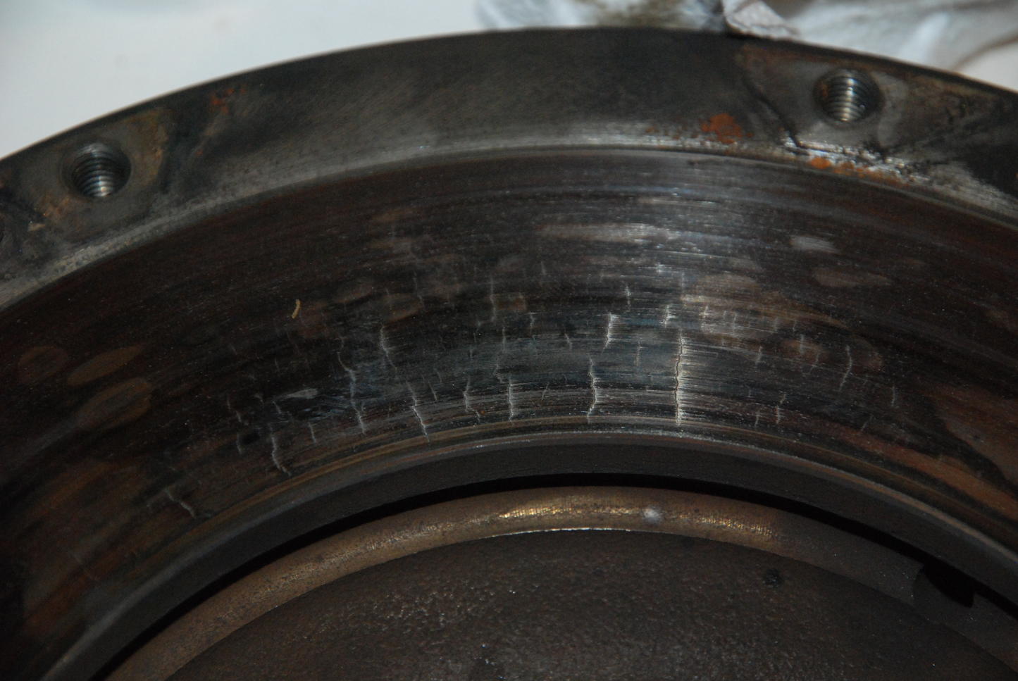

I just got my transmission pulled out to change my clutch and rear main seal. The flywheel is grooved, has about 50 cracks, and has heat marks.

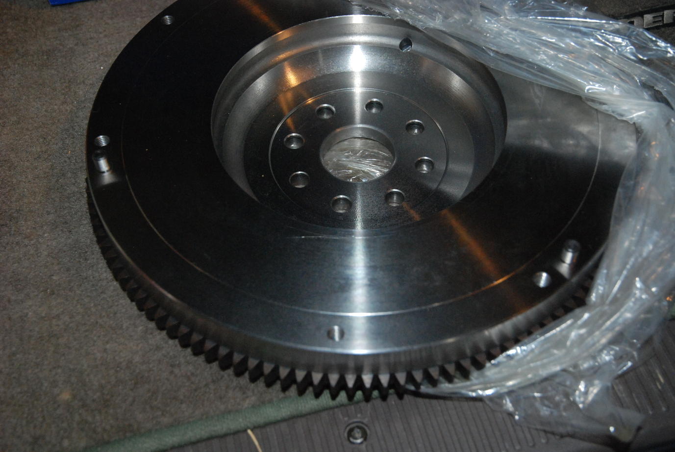

I opened up my NAPA flywheel and the package is LUK! It better be a different design than the $50 LUK branded one or I'm going to be mad.
Here's my old one so you can see how bad it is...

Well, after driving it for a few days, the flywheel is crap. About 5% of the time I go to start it, the starter doesn't mesh with the teeth on the flywheel...

Have you had any other problems like starter teeth breaking? Apparently the LUK flywheel has a terrible design flaw.
Was the transmission abused or driven improperly? I'm curious how cracks develop like that.
Not with me, but I've only had it since October 2014 and it has 264k miles.
