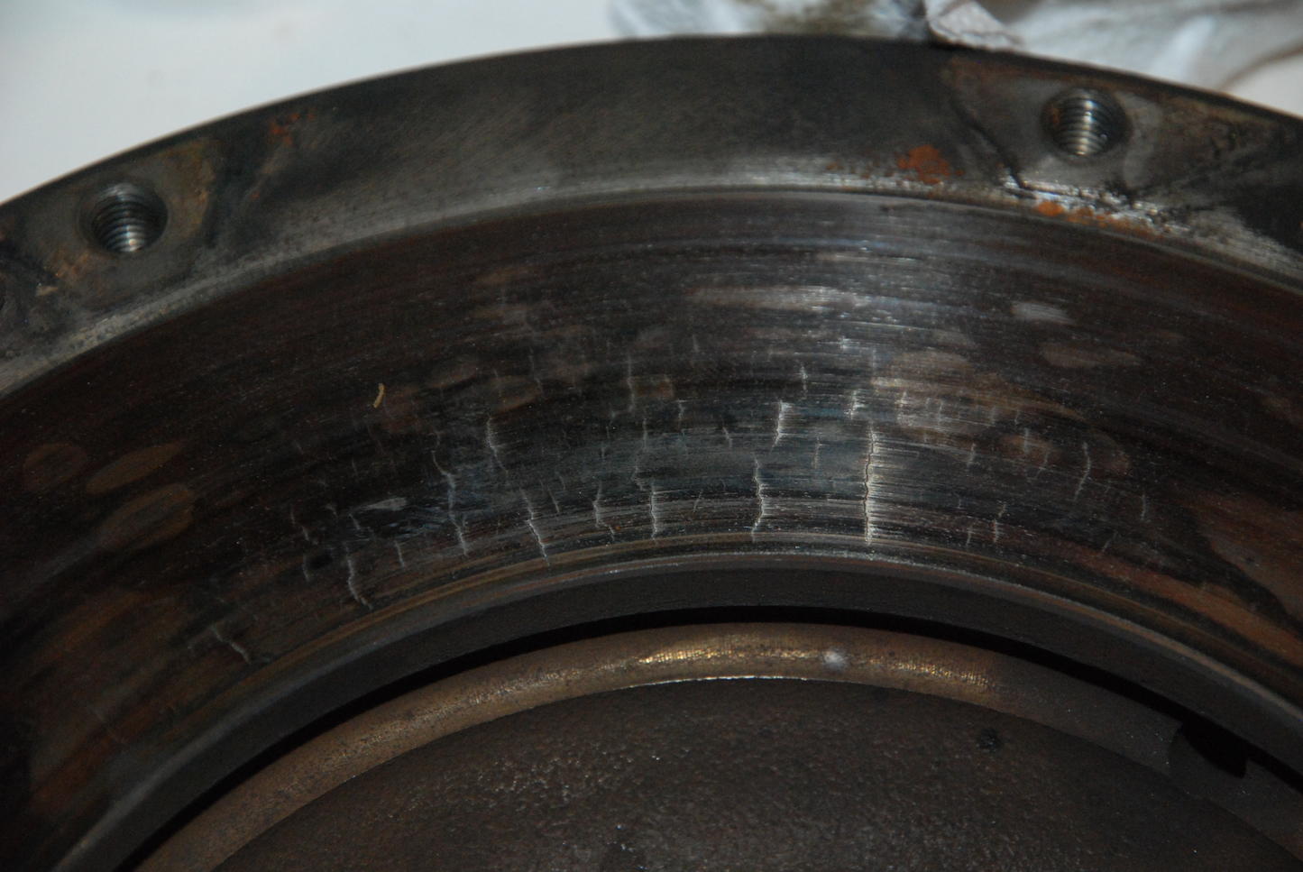

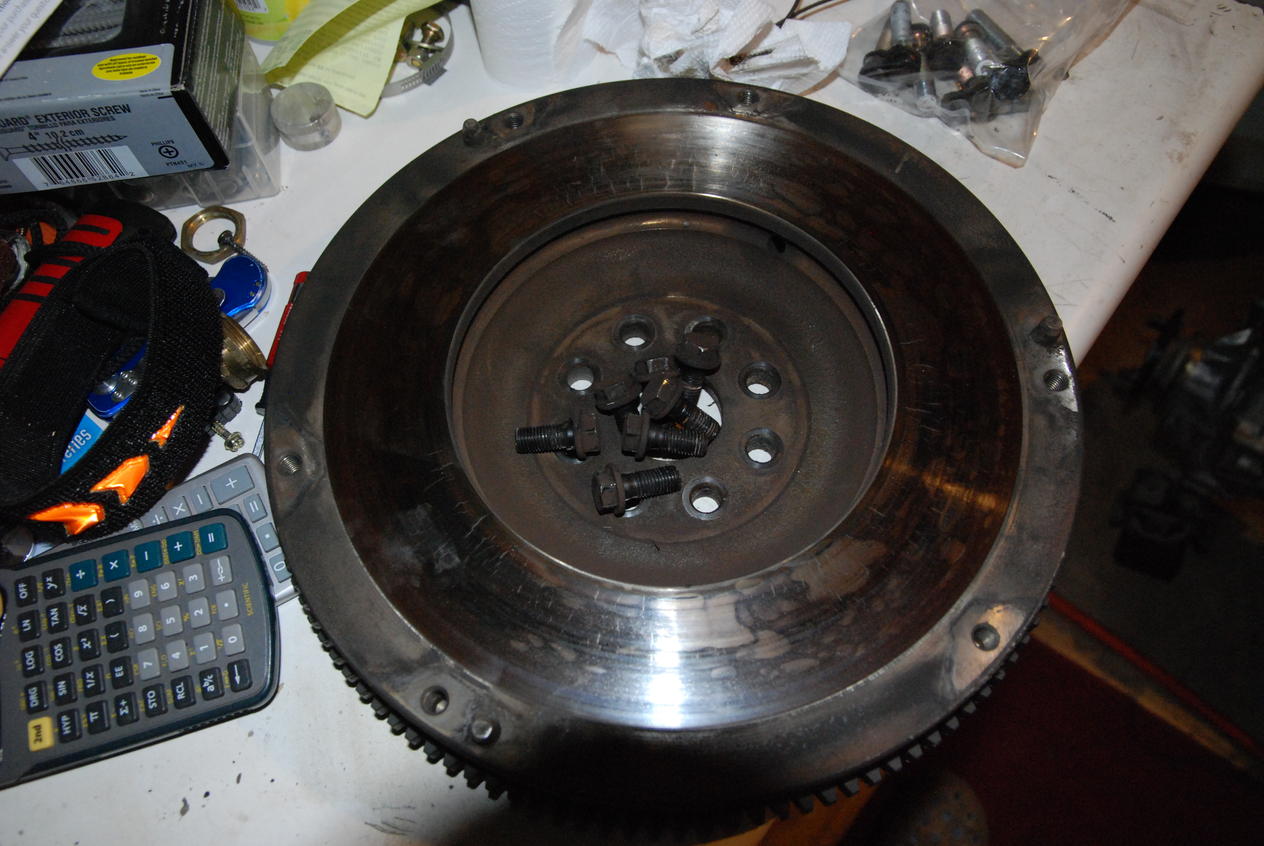

Finally pulled out the messed up flywheel.
I'll be resurfacing an oem flywheel I pulled out of another 3rd gen instead of putting in another one from China.
Does anyone know how many times the OEM flywheel can be resurfaced? Or is there a minimum thickness?
My OEM flywheel/clutch lasted 330,000 kms and still had life left.
You can see from the picture of the two flywheels together that the teeth are totally a different design. Probably a good idea if you have a high milage 5 speed to source a good used oem flywheel before you replace the clutch
