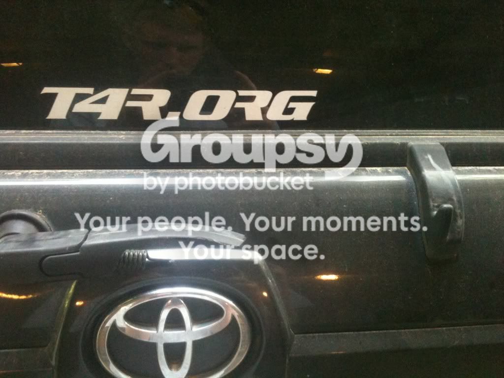

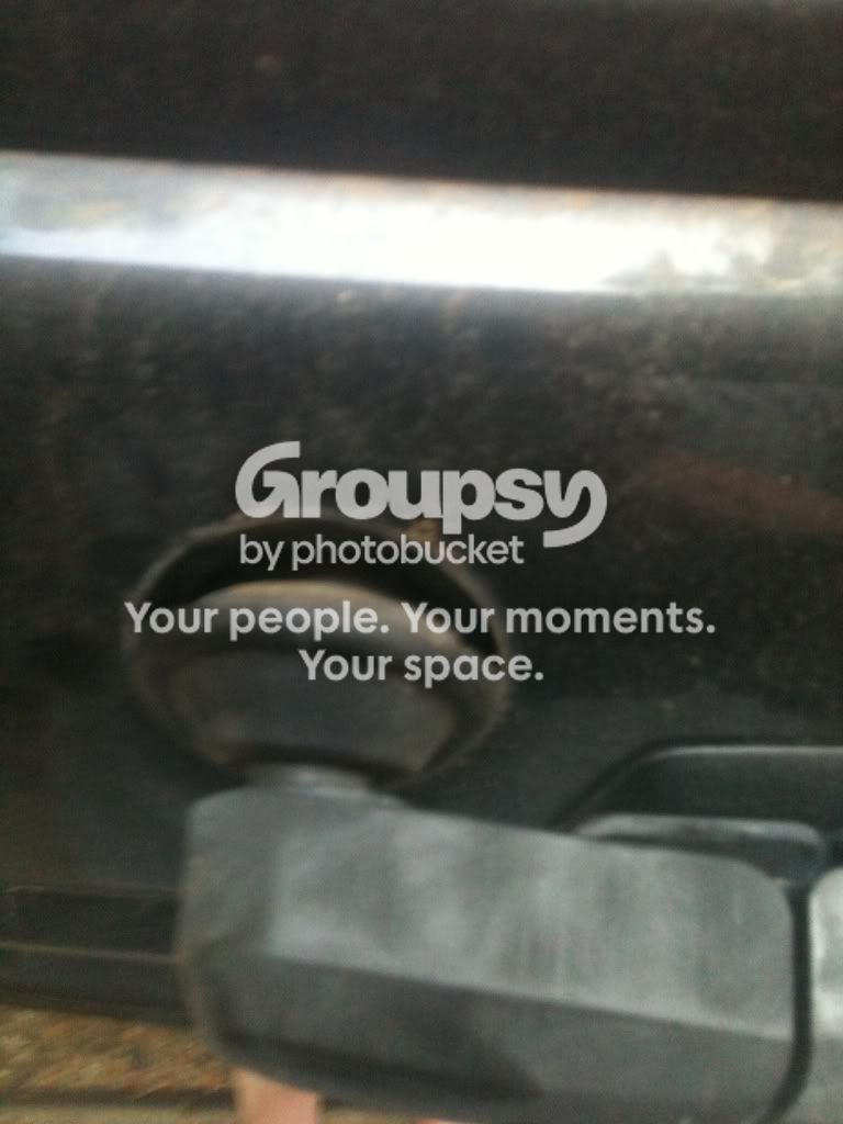

So I was going to give the runner a little TLC today by giving it a good wash. Went to pull out of my garage and didn't realize that I had left my rear hatch up. So, I ended up driving out of the garage with my hatch open and snapped the rear wiper blade off. Any idea how much this thing will cost to replace?

The entire wiper arm isn't very expensive, some people replace them every time the wiper blade needs replacement. IIRC, it is under $30.
However, from the looks of the bottom picture, it does look like you bent the threaded end that the arm attaches to. That might not be an easy fix. The end cap pops right off and exposes a nut, which can be taken off with a socket or a wrench (I believe it is a 10mm nut). Take the wiper assembly off and see if the threaded end is bent. Then troubleshoot from there...
Just ran out to try what you suggested, I managed to put the rubber piece back in and it looks flush and normal. Also tried running the wiper and everything looks as if it is functioning normal. However, i can't seem to figure out how to get to the bolt you mentioned
My rear wiper got ripped off at a car wash, so the manager agreed to replace it for me. The whole arm and new blade cost $90 at my local stealership.
If the rubber piece is sitting flush and the threaded end looks like it's in the middle of the hole, then you probably didn't bend it.
As for getting to the nut, the end cap will pull right out (then it will be on an angle), then just spread the two little "wings" apart (the tips of the horseshoe looking piece) and it will come free.
If the nut is rusted/corroded pretty bad, it will help to spray it with some PB Blaster, Liquid Wrench, or WD-40 and let it soak for a while before even trying to get that nut loose.

Took the runner up to the dealer today and a hour and $54 later I had a new windshield wiper arm.
The good: my windshield wiper is still functioning.
The bad: the wiper blade is not sitting flush with the back window. The service writer said that it appeared that I bent part of the tear hatch where it meets the blade, it's almost impossible to see however I could feel the bend. He said that it was either a problem with the wiper motor or the bent hatch was the problem. I decided for now to just leave it as is and try to diagnose the problem. Don't want up make a claim on my insurance just for a rear windshield wiper.
