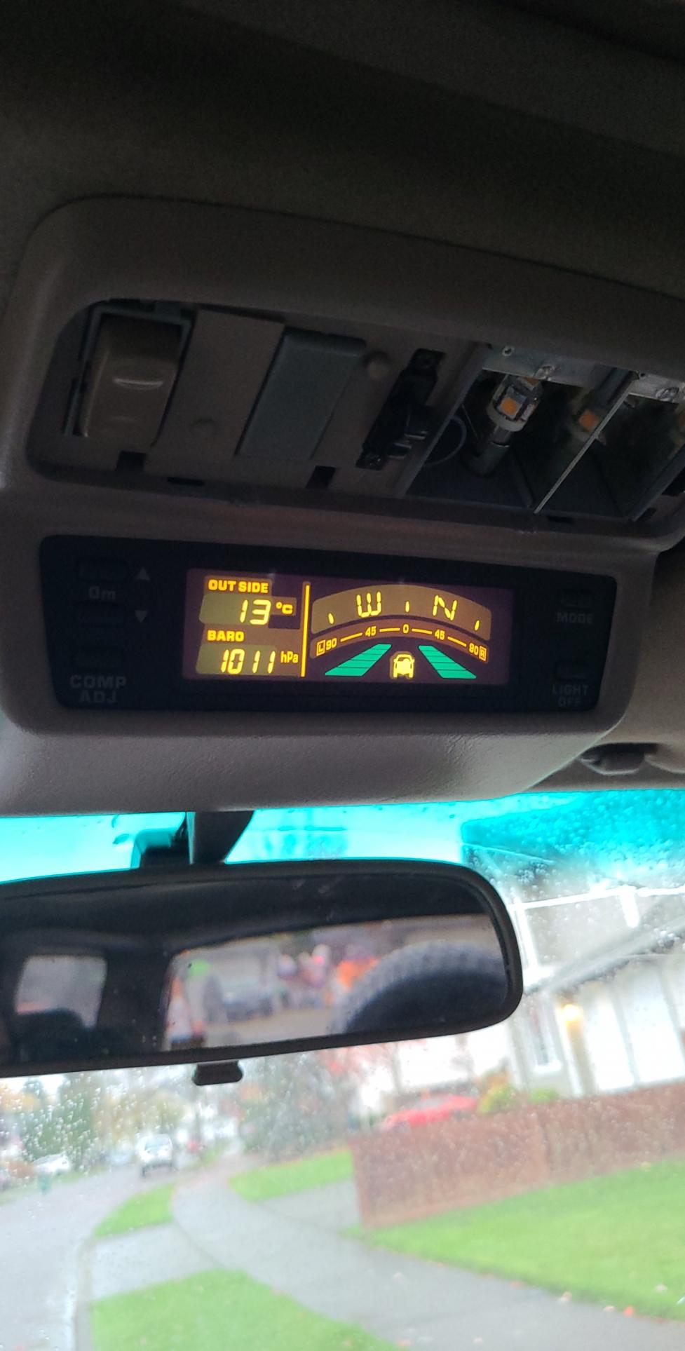

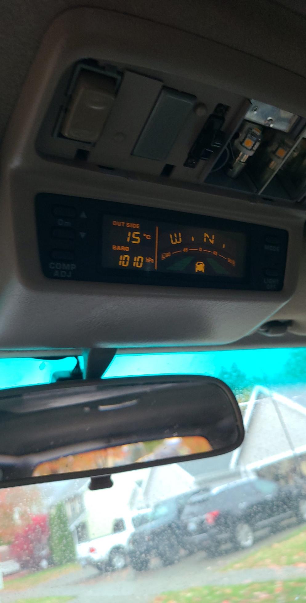

Absolutely zero difference. Pics are while driving east and west on the same road; tried calibrating it 3 times before I left and another 4 times before taking the second picture. Tried both circles and doing the 4 right turns. Speedometer still works this time, though.

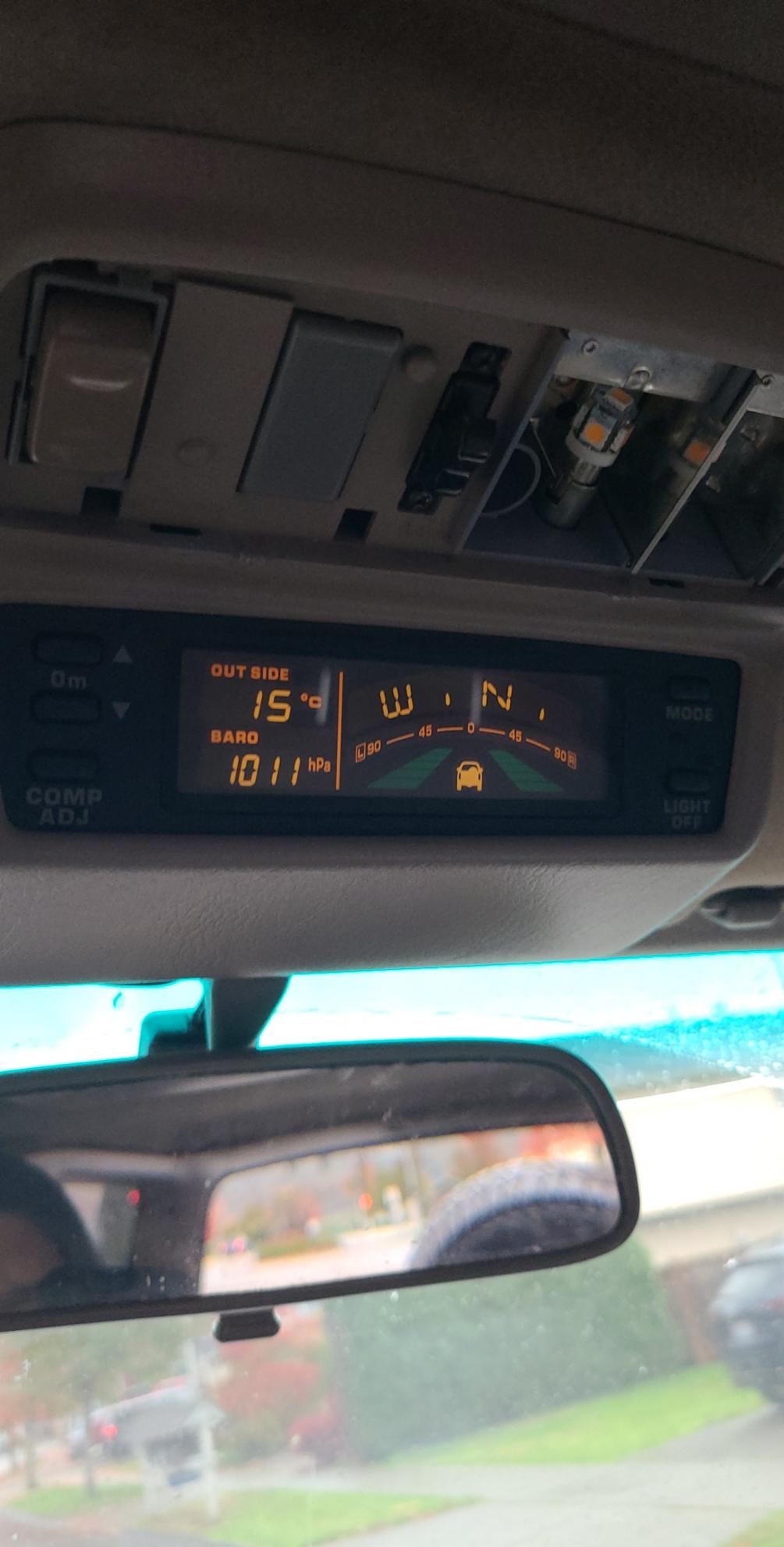

Parked, facing south, headlights off so the display is better illuminated (between this and the last pictures I turned off the car while parked in my usual spot before deciding to flip around and grab another picture. Because of this, you can see how the compass has shifted SLIGHTLY because I parked more directly towards NW in that time.) Green bars and L/R seem to be constantly lit up? Or is that how bright they should normally be?
The most help I've seen from Toyota themselves is "Do not perform circling calibration of the compass in a place where the earth's magnetic field is subject to interference by artificial magnetic fields (underground parking, under a steel tower, between buildings, roof parking, near a crossing, near a large vehicle, etc.) / During calibration, do not operate electric systems (moon roof, power windows, etc.) as they may interfere with the calibration." From this my only other guess would be to try it in the middle of a corn field and perhaps have my headlights off, and if that doesn't work then maybe re-do every connection?
Edit: just tried exactly that 3 more times, with both headlights and radio disabled. Nothing.

the bars only light up in a traveling way, one after the other, not all at the same time.
Hmm. Interesting. Wonder if it's a power/ground issue maybe? Wouldn't hurt to try

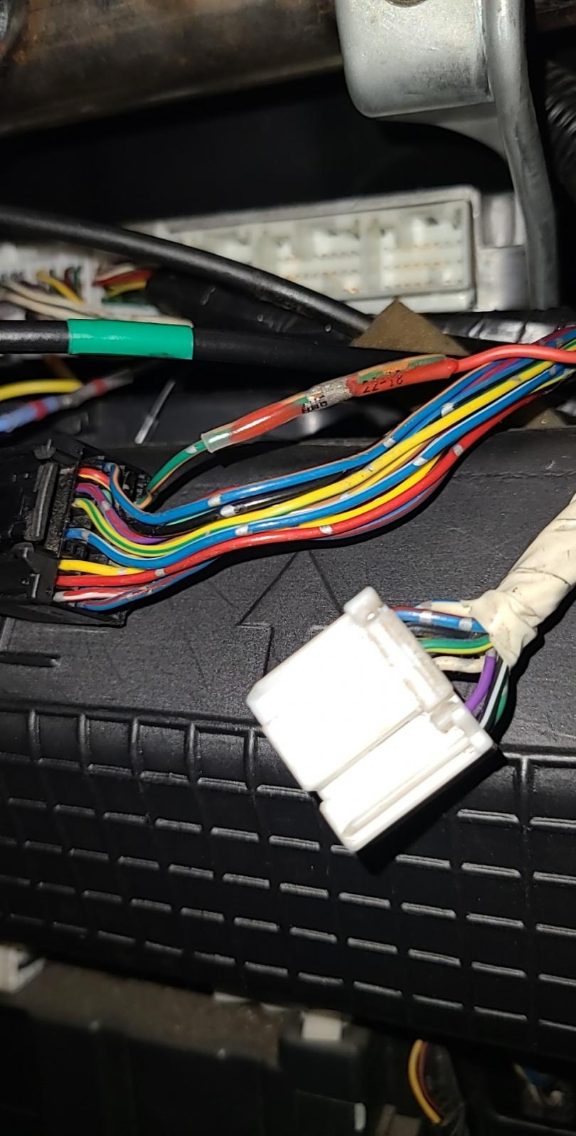

I get that, my point is it's clearly the splice causing it, the question is why it's happening not what is happening
If even one of the ECU's plug was loose the car wouldn't start, let alone operate totally fine in every other regard - if that was the case I could expect at least one other thing connected to that plug to be going wrong as well but that's not happening here
The actual splice pictured above looks textbook to me but if anyone has an idea on how it could be better, I'm all ears over here
