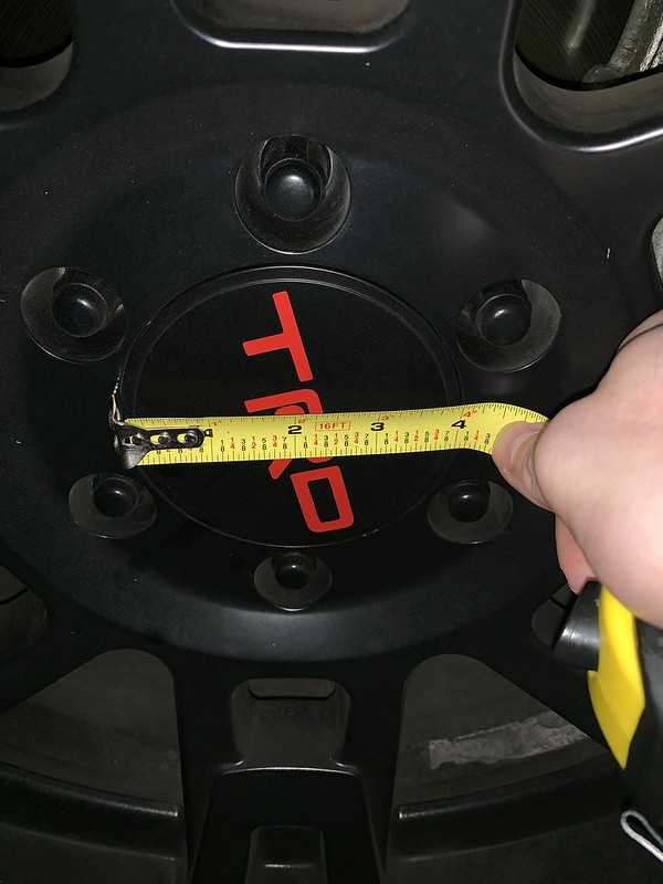

Does anyone know what the center cap size is for their 17" wheels, specifically the FX Pro? I believe per looking at the wheels they all are the same in that area so it shouldn't be different as far as wheel size? But I'm not 100% sure.
I'm completely lost with how to measure them and what not. I have a couple broken ones and need to have them replaced. They are currently moving to a new location, and while I left Dustin a message, I doubt I get a call back anytime soon (and I understand why).
Basically trying to find something on Amazon that'll work temporarily. Does anyone know the mm size I need?
I know the OEM TRD Pro caps didn't work, but I believe that's because of their design, not size. So should I still be looking at a 62mm to fill the FN Wheel? Or is it a whole other size entirely?
Thanks for any help!
Dustin included OEM silver TRD center caps with mine and I'm almost certain they're from an FJ TRD wheel as they're the only ones that fit.
I know I'm not directly answering the question but if you can find dimensions for those silver FJ TRD caps it should get you going in the right direction.
t4rlol is correct in that the size is the exact same as the FJ TRD wheel cap. You can find those by Toyota part #PTR18-35092. Dustin does provide a cap with any wheel order specifically the FN Pro's and those are 4" diameter. See below:
