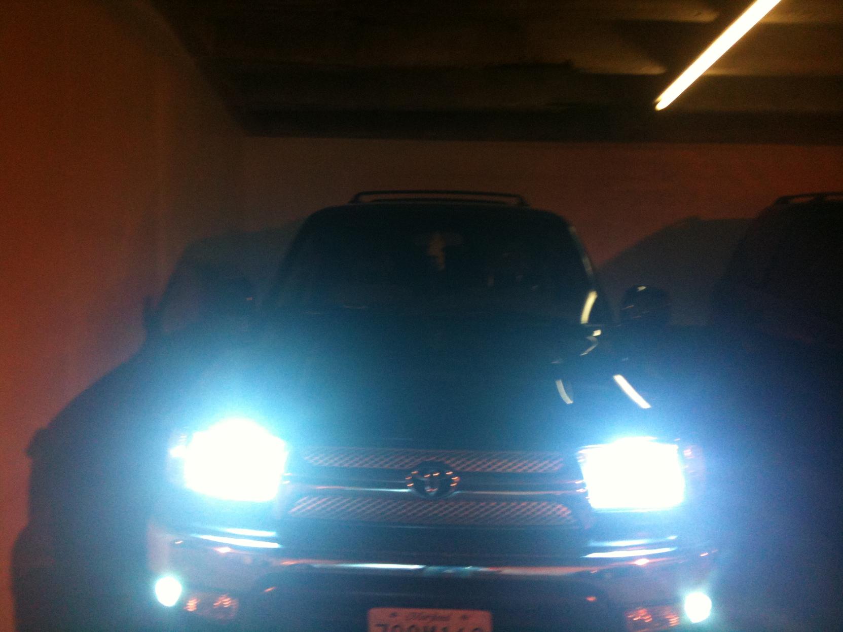

Getting ready to install hids into my stock fog lights. Can someone who has done this post a pic of what it should look like after modifying the cover to make the bulb fit?

ive done it. the bulbs are pretty long. i just ghetto rigged it with some ties and cut a hole in the boot to make it fit. i sealed up the boot with rtv silicone sealant afterward.
im using the ddm kit with 3000k bulbs.
ill be taking my fogs apart again (they're flooded with H20) so when i do ill post pictures.
Thanks guys for the replies. I did not know that HIDs were hotter than a Halogen bulb. I have HID headlights and just wanted to get the fogs to match. Im running the DDM 5000k kit so i was thinking that maybe some silverstars might come close to the HID color (not so yellow).
