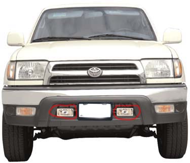

I want to add fogs to my 2000 T4R. what do you think of this look? i know i have factory mounting point for fogs, but the cheapest i can find those are for $130. i can get some rectangular fogs for 35 bucks. i will add the factory ones later but for now i would like something that will help me out on my nightly drive home on back roads
opinions?

Looks okay, would like to see them in person though. If you like them, i don't see any reason not to get them.

no. i don't have them. i want to eventually add them but the cheapest i can find them for is $130. so for now 40 bucks all said and done sounds good to me and i'll add the factory style ones later after i get further down on my mod priority list

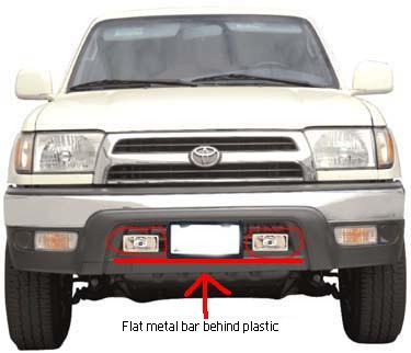

2000t4rAKS: have you tried changing the bulb in your factory fogs? i've heard that can make a big difference. if you do change them, yellow/amber light is supposed to be better in bad weather so you could try some Hella Yellowstar bulbs. As for the valence. there is a metal bar that runs across the bumper behind the plastic that i think would be perfect for mounting lights. and i think you would only have to cut one of the slats depending on the size of the lights. i'm going to try to reglue it at a right angle to see if i can make it look somewhat factory. i'll do a write up when i''m done

I don't think they look as good as the OEM fogs (only aesthetically speaking), but they will probably get the job done. For $30, why not? :bigok:
My '99 Limited came with those OEM corner fogs and I must say they really su$k.
I installed a set of no name 55w fog/driving lights for the rear and they RULE. Like $30 at NAPA.
If it was me, I would get the simple rectangular driving lights, cut out the divider and mount them right in the facia as you show in your picture.
For wiring, I liked running to the battery (w/inline fuse) and installing a simple rocker using one of the empty switch positions on the lower left, below the dimmer knob.
Skip the OEM's, not worth it.

Either way, i think i'll go with some aftermarket ones by the license plate and maybe add the OEM's later
thanks for all the advice! :)

Right now i'm running Blazer All-Weather Halogen Fog Lights(cheap no-names from Walmart) just so i could see how the fogs would work. i will probably drop in some Hellas later. the Blazers measure 5 1/2"W x 3"H so they are pretty small. i don't think you can fit anything that much bigger in there because i'm pretty sure i measured it at 6"W x 5.5"H then it tapers off to 4"W at the top. you could always mount the license plate somewhere else and then you would have plenty of room
