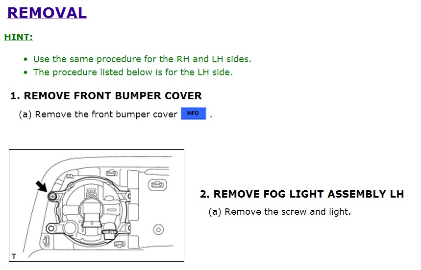

Yes the fog light is a one piece sealed unit, so if you say the glass is gone, you're going to need to order an entire fog light from the dealer; it's also left and right specific, so make sure to order the correct side. And yes, it's separate from the turn signal assembly. To replace it all you really need to do is unscrew it from behind, disconnect the plug and pull it out from behind.
I recall there's only one bolt holding it on and I could reach it just by sticking my hand up from under the bumper, but I also have a TE and I think there's a lot more open space. If you have an SR5/LE it might be a bit more complicated and you might need to remove some trim pieces to reach it? I am not really sure about that...but all in all it should be straight forward and I'm sure you can figure it out.
Below is a screen shot from the FSM, in case you are having trouble downloading it. It seems to tell you to remove the entire bumper, but I think you might not need to if you can just figure out a way to get into that spot. Like I said I was easily able to pull mine off and put it back in no problem, so hopefully there's a way to do that on the SR5/LE too.
