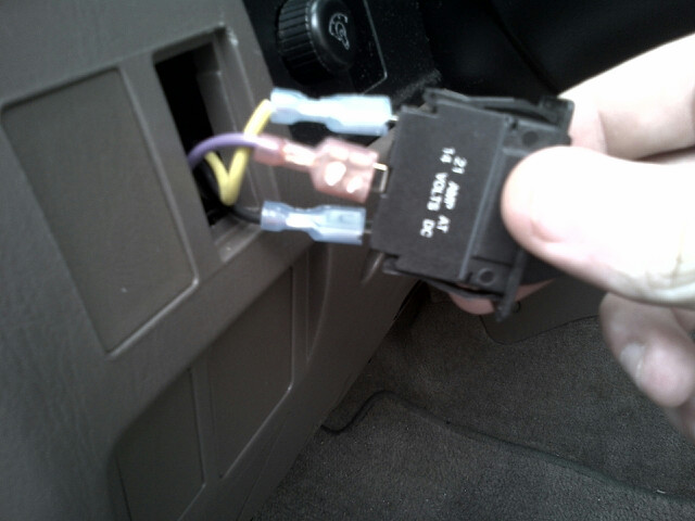

I installed the dealer-optioned Hella lights on my 98. Took everything right out of another 98 that had the option from the dealer, I took the lights, relay, fuse, and switch straight out of the truck I have not changed any of the connections so I know the wiring is correct. I did have to disconnect the switch to run the wires through the firewall and I thought I connected them the same way but I can't get the light to come on the switch or the lights themselves.
The picture below is how I hooked up the switch (purple is the ground). I put a new fuse in but I have not replaced the bulbs - I don't think that would stop the light from coming on the switch would it?
Anyone have any insight? Could it be a bad ground, I thought I did a decent job grounding it.
Ok I hate to really open up this thread again but I am having the EXACT same issue. I am working on a 1997 with the factory/dealer installed FOGS in.
I have replaced the rusty HELLA relay. Found one online and NAPA and replaced the 15 amp fuse. The moment I put the fuse back in, i can hear the relay clicking. GREAT! Go to the switch which is also factory installed with the orange light and nothing. No light no nothing.
The wiring is Black (ground) top, Purple in the middle and yellow at the bottom. I cannot figure it out. Anyone, please let me know.
