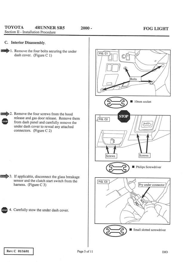

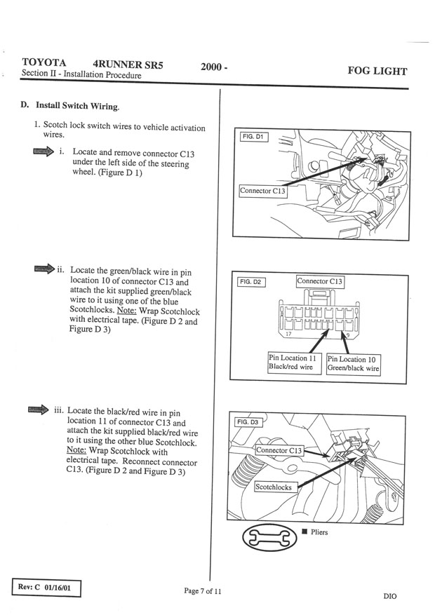

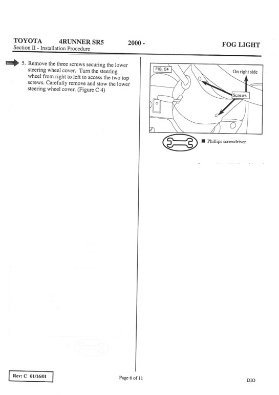

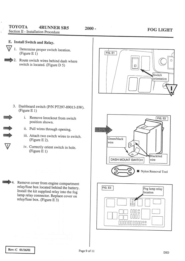

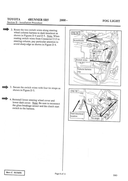

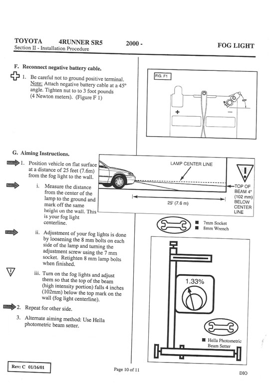

Ok so im about to hook up my new fog lights to the runner and im stuck on the one wire where you have to hook into your driving lights. Im confused on how to do so, If someone could give me pics of how to do it step by step or find a video of something.

If you are doing a standard install using the stock wiring harness and an aftermarket switch you basically want to install the switch to short wires 10 and 11 on the 17 wire harness connector under the steering wheel. If you unplug the harness, the pins should be marked. Wires 10 and 11 were the red/black and green/black wires for me. I'm not sure which is which and I'm not sure if it will be the same for you.
Keep in mind, this is from memory and it was done on a 2001 SR5. I think this will only apply to 99-02 models

haha thats a bit confusing. Im sure ill be able to figure it out.. Its gonna take a while though, I would still appreciate some pictures of the wires i am supposed to connect to.
