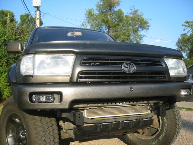

Sorry about the delay, today was my day off and I totally spaced taking pictures of my setup for this thread. Basically all I did was use Simpson Strong-ties to fabricate a light mount. I used one 4" 90 degree angle, one 6" straight section and another 12" section. The angled piece is bolte to my radiator support and the 6" section to that. This brings the mount through the grille where the 12" section is mounted horizontally. The lights are then bolted to this horizontal section. Hopefully that makes sense and I'll try to get some pictures up.

Alright, sorry for the delay but here's my current setup. Again it's just Simpson strong-ties that hold everything together. Very strong and durable. Best of all, with two more ties I can add more lights to the front relatively easily. Enjoy!

This picture above show the wiring. I spliced in a two pin trailer connector so the wiring can be unplugged if I ever need to remove the lights off the front. The front horizontal tie can be unbolted and the wiring unplugged tehn the whole assembly simply lifts off without the need to uninstall the entire mounting setup. This way the lights also stay properly aimed.
