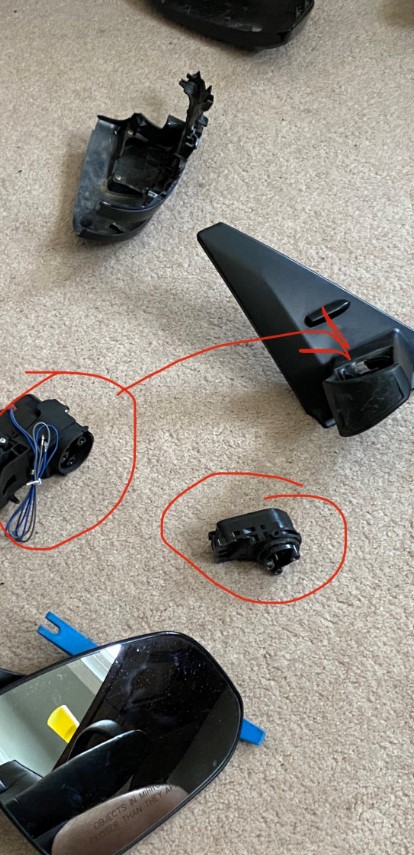

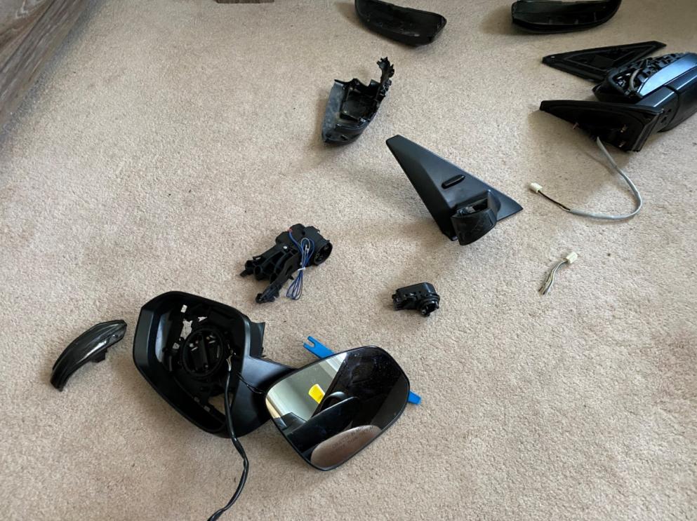

OK gents, I'm having serious doubts about this kit right now and I need someone to tell me I'm doing something wrong. I disassembled the passenger side mirror completely and I'm stumped on how the new arm (left) sits into the joint of the mirror (old arm mount circled in the middle). I've seen pictures of other kits (KTJO maybe?) and the bracket that the mirror mounts to in their pictures looks different than mine.
Any suggestions would be greatly appreciated!
DM me and we can talk.
