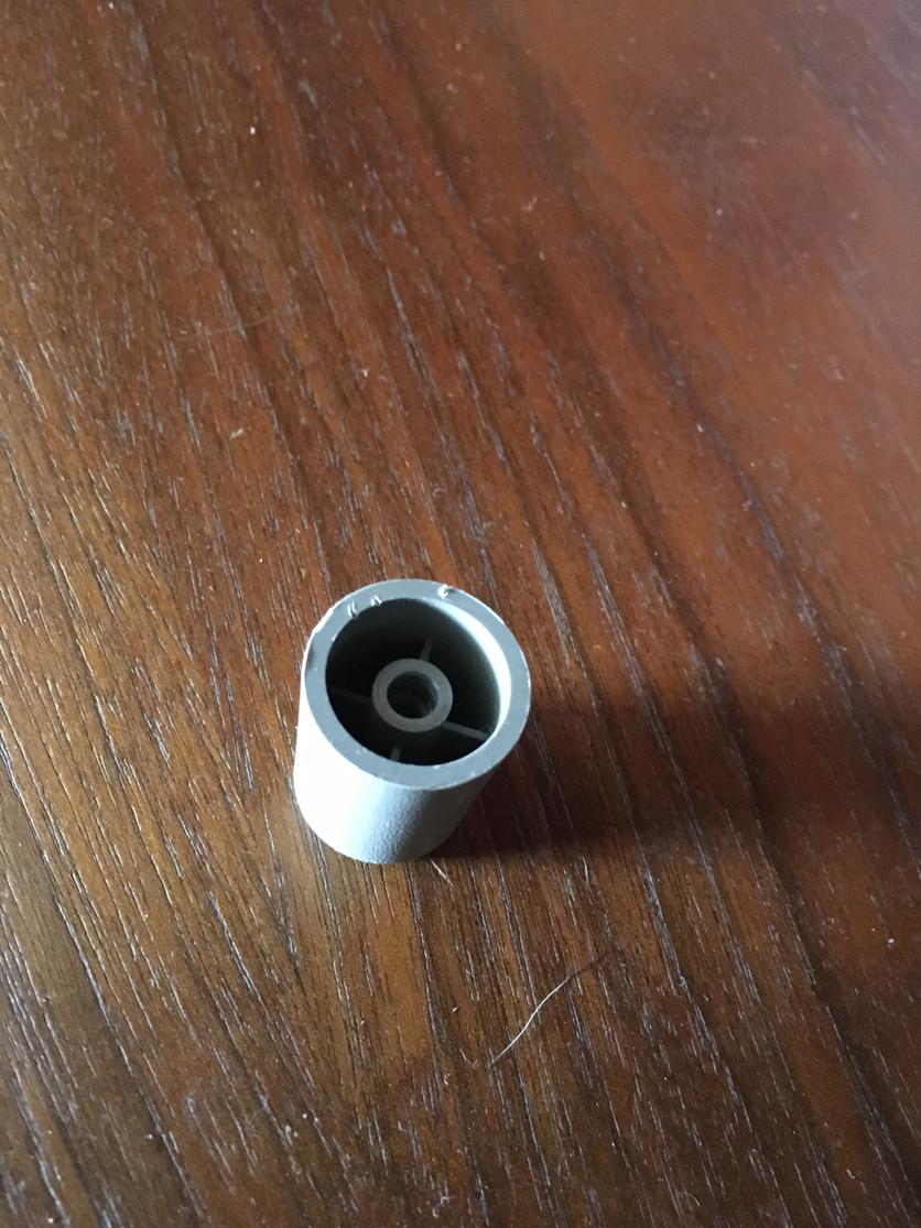

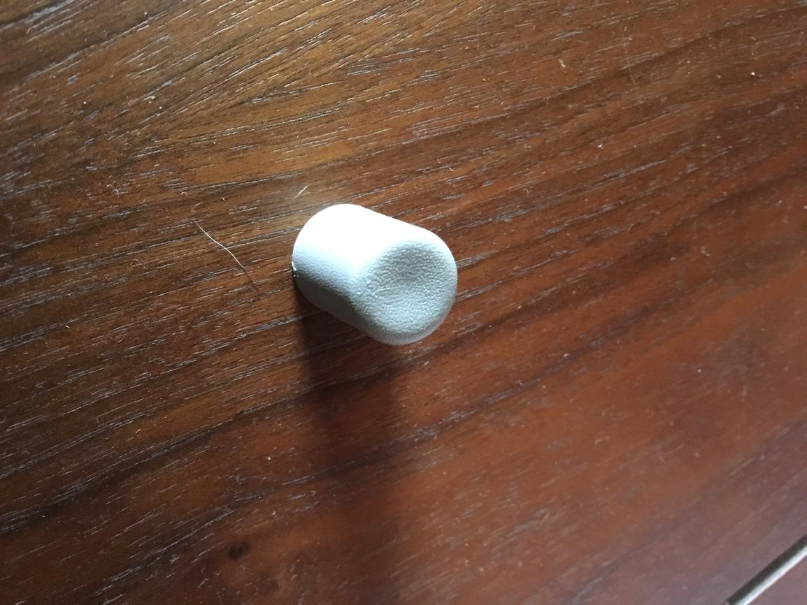

Found my button!
It was on the floor, where it had fallen out when I put down the setback. It's diameter is about 3/4" and it's an inch and about 1/16" tall.
I'll try to attach two pics.

Found my button! Part 2
Reinstalling will be a pain. I'm going to try to wrap some dental floss around the post to pull towards center so I can thread the thing back on. Wish me luck!
Reinstalled it!
Well frankly, that was pretty easy. Just made a sorta slipknot/lasso, dropped it around the shaft and fiddled around 'til the button found it. (Insert joke here.)
